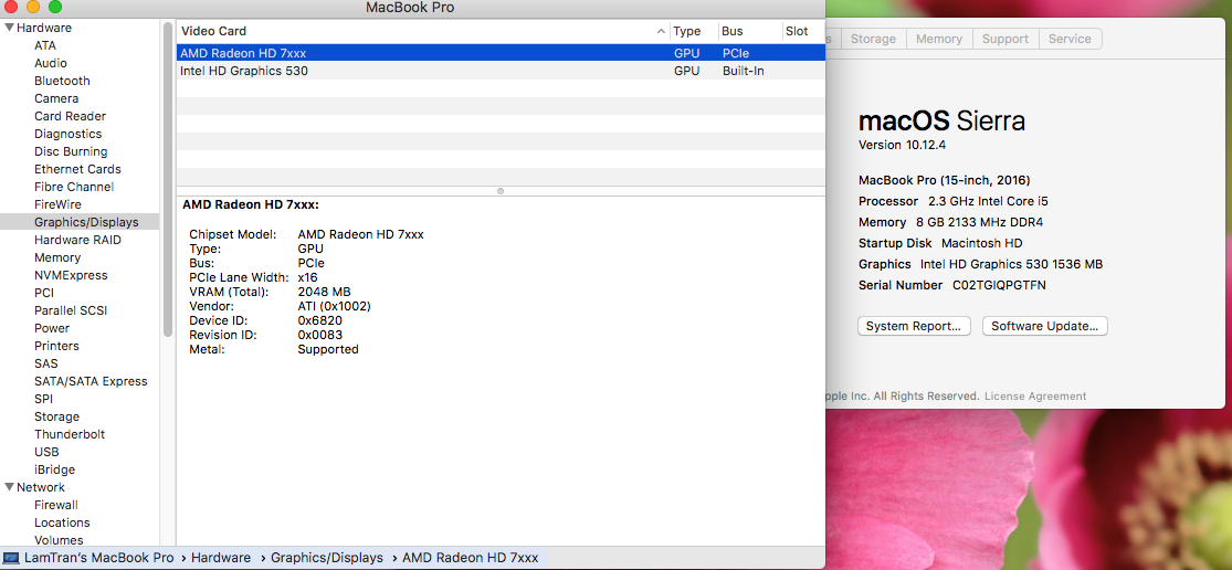

lamtran Posted May 13, 2017 Share Posted May 13, 2017 hello, my 7510 running almost ok with 10.12.4, had connected with Firepro graphics card like this, but I could not connect with seccond displays to HDMI or mDP. I had tried disable intel graphics, it had only show up a yellow screen Link to comment Share on other sites More sharing options...
Moderators Jake Lo Posted May 13, 2017 Moderators Share Posted May 13, 2017 Looks like you have Switchable Graphics enabled in the BIOS. As you can see the system is using Intel 530 graphics and HDMI/DP are connected to the AMD card. To disable the Intel card, you need to disable Switchable Graphics. Try enabling ATI in the Config file or during boot in Clover Options. 1 Link to comment Share on other sites More sharing options...

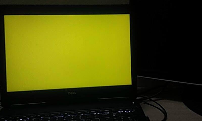

lamtran Posted May 14, 2017 Share Posted May 14, 2017 when i disable Switchable Graphics, login screen show up only a yellow ( after finished boot loadding) Link to comment Share on other sites More sharing options...
