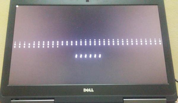

lamcrkh516 Posted December 16, 2016 Share Posted December 16, 2016 Another problemAfter load finish. Screen error like this Link to comment Share on other sites More sharing options...
Administrators Bronxteck Posted December 16, 2016 Administrators Share Posted December 16, 2016 what happens if you wait a bit does it stay like that? Link to comment Share on other sites More sharing options...
Moderators Jake Lo Posted December 16, 2016 Moderators Share Posted December 16, 2016 Try with Switchable graphics enabled and disabled? Link to comment Share on other sites More sharing options...
lamcrkh516 Posted December 17, 2016 Share Posted December 17, 2016 Hi got it solved. I was missing the IO kit patch. running good now. any I idea, My bios Optimus switching goes off after every boot. I want to leave it enabled. thanks My case seem like this when switch graphic disabale Can you show me how to add io kit patch. Thank you so much Link to comment Share on other sites More sharing options...

lamcrkh516 Posted December 17, 2016 Share Posted December 17, 2016 what happens if you wait a bit does it stay like that? I waited about 1 hour but don't have anything happen Link to comment Share on other sites More sharing options...
ss2sameer Posted December 17, 2016 Author Share Posted December 17, 2016 hi to install El Captain use the attached config file and kexts in clover bootable pen drive. you'll will be able to boot fine and be able to install. will require an external mouse. keep switchable graphics off. I have installed elcaptain in three different 7510 using the above method without any problems. once OS X is installed, install the appropriate NVIDIA web driver and use nv_disable=1 without it. you should be fine. if you use my config file. kindly create your own SMBIOS serial no. Hope this helps clover_pendrive.zip 1 Link to comment Share on other sites More sharing options...

ss2sameer Posted December 17, 2016 Author Share Posted December 17, 2016 with NVIDIA M1000M i had to use IntelBacklight.kext in clover folder and apply AGDP fix to avoid the black screen at the end of boot. still get black screen but closing the lid and opening it back gives me the login screen after the above fixes. Some times it works fine. don't know how to get rid of this problem. Hope this helps Link to comment Share on other sites More sharing options...
