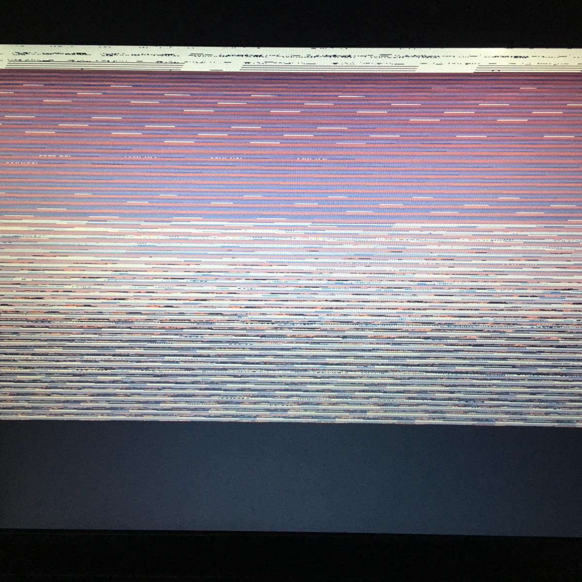

On E5x30/E6x30, BIOS must not exceed a given version beyond which graphics artefacts is systematic. If BIOS does exceed the maximum recommended versions, downgrading to the desired version requires to first downgrade to the lowest possible version before subsequently upgrading to the desired one.
Eg: E6230 with say BIOS A16. Maximum BIOS version for OS X is A11. To downgrade to A11 and have fully supported graphics, it's necessary to 1st downgrade to say A02 version then upgrade to A11. A direct downgrade from A16 to A11 does not fix graphics defects.
It appears that Jake recommended not to exceed BIOS A06 for the Latitude 6430u. As such, downgrade to A02, then upgrade to A06.

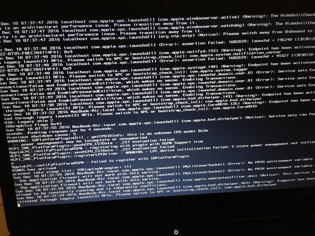

I did one by one BIOS upgrade till A06, on each iteration I tried the installer, the results were the same timeout.
Then I took the latest update from Jake Lo, shutdown error is back and some acpi errors and CPU model is unknown, please find attached.
