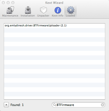

According to your snapshots the bluetooth kext seems like broken, so i suggest you to install vanilla bluetooth kext again and try my kext v2.1 then let me know with an ioreg file and system log.
EmlyDinesh,
I reinstalled the vanilla IOBluetoothFamily kext from Mavericks Install DMG, along with BTFirmware2.1, Unfortunately the same result, BTFirmware does not get loaded by default - I even used -f UseKernelCache=No boot arguments. Had to load it manually - I am attaching IOReg file and the System Log file which I saved after loading your kext.

EmlyDinesh,
I am begining to think this might just have to do with the BIOS whitelist - As the BT Hardware was never detected in Windows either, The WiFi was neither, till I taped out pin 20 on the card, now the WiFi portion works in Windows and Mavericks, but the On/Off touch button does not change the state of the card, the WiFi LED indicator light never comes on either.

Your bluetooth was not recognized in OSX as well according to your ioreg file.

This tell me that your Vanilla IOBluetoothKextxxx is not very good. So, i suggest you to try installing vanilla IOBluetoothFamilyxx kext back without any changes to the kext. Also i found that my kext is loading at the end of the boot instead of at the beginning, do you change anything in my kext from v2.1? What is your OSX version?
2014-01-23 07:39:55 +0800 com.apple.kextd[12]: Kext id com.apple.iokit.BroadcomBluetoothHostControllerUSBTransport not found; removing personalities from kernel.
I've found this in your log, which indicates my kext is working fine and uploaded firmware successfully.
2014-01-23 07:39:55 +0800 kernel[0]: Bluetooth Firmware Uploader v2.1 by EMlyDinEsH(OSXLatitude) © 2012-2014, CREDITS: mac4mat(tonycrapx) and laloch(archlinux)
2014-01-22 23:40:02 +0800 kernel[0]: Bluetooth Firmware Uploader:: Successfully patched the firmware
