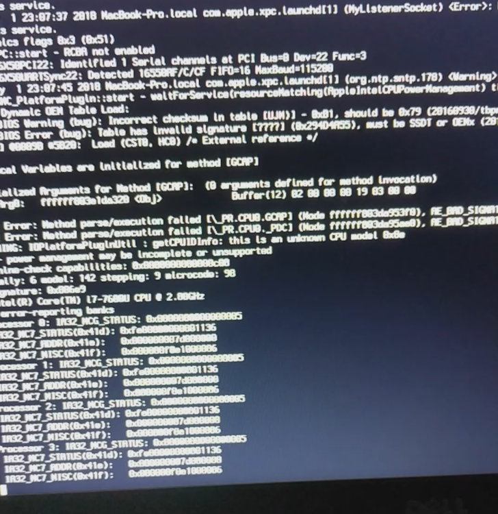

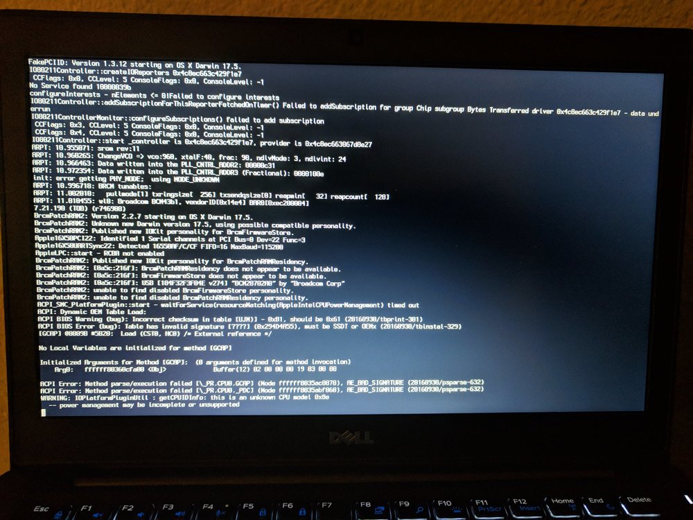

abraxis Posted May 2, 2018 Author Share Posted May 2, 2018 yes, it prevents from booting. The error flies by very fast hope you guys can read this screenshot bios warning (bug) incorrect checksum in table - 0x01, should be 0x79....etc Link to comment Share on other sites More sharing options...
Moderators Jake Lo Posted May 2, 2018 Moderators Share Posted May 2, 2018 boot with verbose & debug 0x100 mode. this prevents reboot on error Link to comment Share on other sites More sharing options...
abraxis Posted May 2, 2018 Author Share Posted May 2, 2018 yes i have the debug 0x100 set. it just hangs after the output and then "please go to panic.apple.com to report this panic" Link to comment Share on other sites More sharing options...
Moderators Jake Lo Posted May 2, 2018 Moderators Share Posted May 2, 2018 is it currently running Sierra? Post your Clover folder for review Link to comment Share on other sites More sharing options...
abraxis Posted May 2, 2018 Author Share Posted May 2, 2018 Yes running sierra rock solid. I changed dw1830 for dw1560. EFI.zip Link to comment Share on other sites More sharing options...
Moderators Jake Lo Posted May 2, 2018 Moderators Share Posted May 2, 2018 Try removing SSDT-3.aml from /EFI/Clover/ACPI/Patched and try again 1 Link to comment Share on other sites More sharing options...
