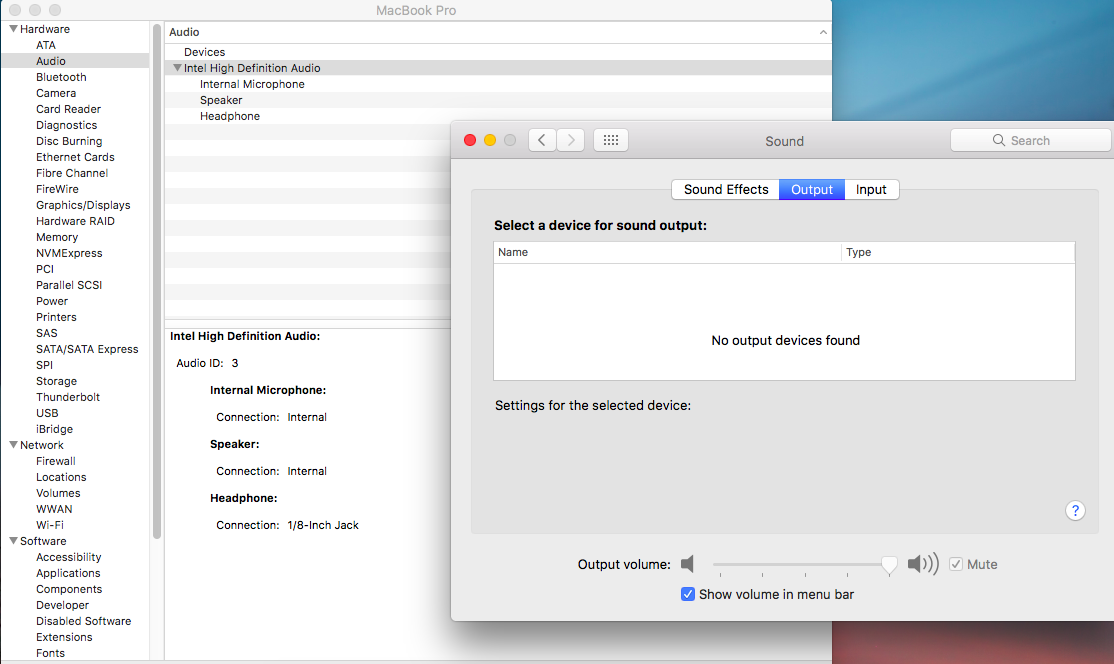

abraxis Posted November 23, 2017 Author Share Posted November 23, 2017 FakePCIID_Intel_HDMI_Audio.kext has always been in /L/E By switch layout ID you mean cloverconfigurator/Devices/ dropdown box/ change to 1? Yea need some serious help with the touchpad. on boot up VoodooPS2Controller.kext claims no ID for ALPS touchpad... AppleHDA_ALC256B is loaded but no audio. Profiler shows audio info tho. weird... Link to comment Share on other sites More sharing options...

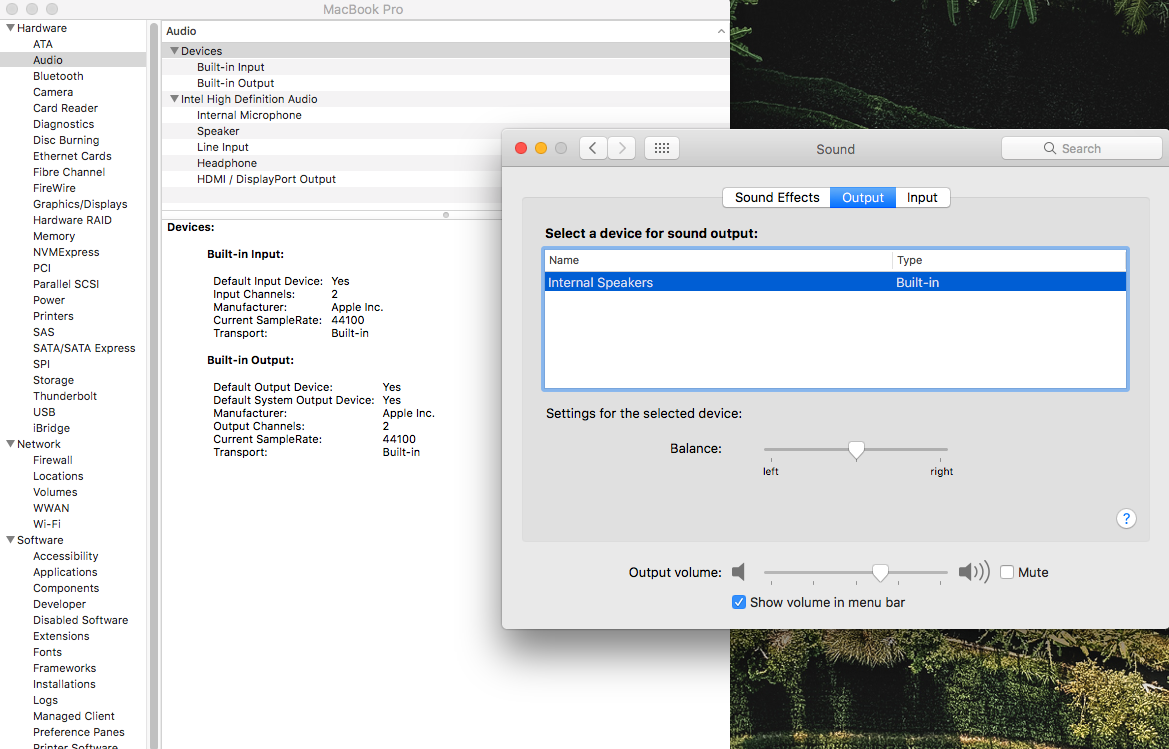

Moderators Jake Lo Posted November 23, 2017 Moderators Share Posted November 23, 2017 Open the Config file with Clover Configurator. Select Devices on the left, in the middle under Audio, it shows 3, change that to 1 and save the file. Reboot 1 Link to comment Share on other sites More sharing options...
abraxis Posted November 23, 2017 Author Share Posted November 23, 2017 Success!!! Audio back. Headphones without distrotion 2 things left HDMI audio and Trackpad. Tried booting with and without FakePCIID_Intel_HDMI_Audio.kext No HDMI audio. 2 random questions * when connecting the hdmi, screen shows static for few seconds before switching... normal? * When connecting or disconnecting Power plug. Computer totally freezes... Link to comment Share on other sites More sharing options...
