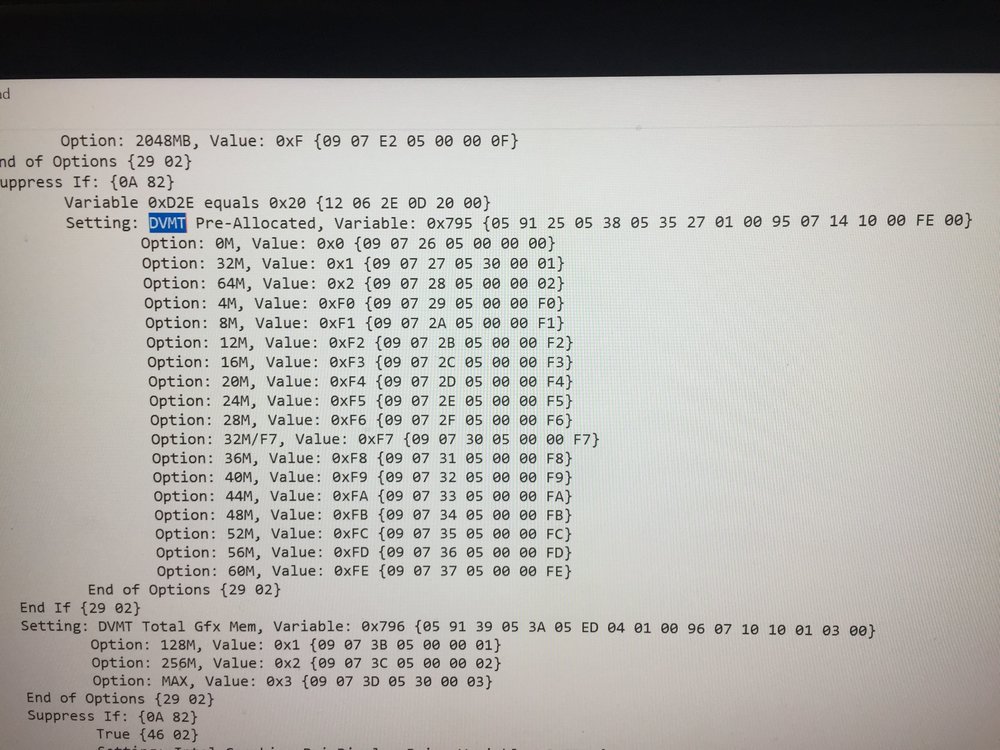

Administrators Bronxteck Posted July 19, 2018 Administrators Share Posted July 19, 2018 ok I just finally dumped my rom and ran IFR on it my DVMT Pre-Allocated does not have 0x05 it only has 0x00, 0M 0x01, 32M 0x02, 64M plus the rest we are not interested in since 64M is the highest table it shows I used 0x05 variable which is not on my list and now I can boot Mojave and HS. I think I needed minimum of 0x03 or 0x04 for latest HS but it would only load graphics every couple reboots. with 0X05 setup_var mojave boots every time with full acceleration before that it would stop or reboot at graphicslock state 1 Link to comment Share on other sites More sharing options...

Administrators Bronxteck Posted July 19, 2018 Administrators Share Posted July 19, 2018 looks like mine.... I got the 0x05 variable looking at a similar model to mine but one generation older that table looked like this Setting: DVMT Pre-Allocated, Variable: 0x350 {05 91 62 06 85 06 5A 27 01 00 50 03 14 10 01 FE 00} 0x39F1B Option: 32M, Value: 0x1 {09 07 63 06 30 00 01} 0x39F22 Option: 64M, Value: 0x2 {09 07 64 06 00 00 02} 0x39F29 Option: 96M, Value: 0x3 {09 07 65 06 00 00 03} 0x39F30 Option: 128M, Value: 0x4 {09 07 66 06 00 00 04} 0x39F37 Option: 160M, Value: 0x5 {09 07 67 06 00 00 05} 0x39F3E Option: 192M, Value: 0x6 {09 07 68 06 00 00 06} 0x39F45 Option: 224M, Value: 0x7 {09 07 69 06 00 00 07} 0x39F4C Option: 256M, Value: 0x8 {09 07 6A 06 00 00 08} 0x39F53 Option: 288M, Value: 0x9 {09 07 6B 06 00 00 09} 0x39F5A Option: 320M, Value: 0xA {09 07 6C 06 00 00 0A} 0x39F61 Option: 352M, Value: 0xB {09 07 6D 06 00 00 0B} 0x39F68 Option: 384M, Value: 0xC {09 07 6E 06 00 00 0C} 0x39F6F Option: 416M, Value: 0xD {09 07 6F 06 00 00 0D} 0x39F76 Option: 448M, Value: 0xE {09 07 70 06 00 00 0E} 0x39F7D Option: 480M, Value: 0xF {09 07 71 06 00 00 0F} 0x39F84 Option: 512M, Value: 0x10 {09 07 72 06 00 00 10} 0x39F8B Option: 1024M, Value: 0x20 {09 07 73 06 00 00 20} 0x39F92 Option: 1536M, Value: 0x30 {09 07 74 06 00 00 30} 0x39F99 Option: 2048M, Value: 0x40 {09 07 75 06 00 00 40} 0x39FA0 Option: 4M, Value: 0xF0 {09 07 76 06 00 00 F0} 0x39FA7 Option: 8M, Value: 0xF1 {09 07 77 06 00 00 F1} 0x39FAE Option: 12M, Value: 0xF2 {09 07 78 06 00 00 F2} 0x39FB5 Option: 16M, Value: 0xF3 {09 07 79 06 00 00 F3} 0x39FBC Option: 20M, Value: 0xF4 {09 07 7A 06 00 00 F4} 0x39FC3 Option: 24M, Value: 0xF5 {09 07 7B 06 00 00 F5} 0x39FCA Option: 28M, Value: 0xF6 {09 07 7C 06 00 00 F6} 0x39FD1 Option: 32M/F7, Value: 0xF7 {09 07 7D 06 00 00 F7} 0x39FD8 Option: 36M, Value: 0xF8 {09 07 7E 06 00 00 F8} 0x39FDF Option: 40M, Value: 0xF9 {09 07 7F 06 00 00 F9} 0x39FE6 Option: 44M, Value: 0xFA {09 07 80 06 00 00 FA} 0x39FED Option: 48M, Value: 0xFB {09 07 81 06 00 00 FB} 0x39FF4 Option: 52M, Value: 0xFC {09 07 82 06 00 00 FC} 0x39FFB Option: 56M, Value: 0xFD {09 07 83 06 00 00 FD} 0x3A002 Option: 60M, Value: 0xFE {09 07 84 06 00 00 FE} if you notice it had more options Link to comment Share on other sites More sharing options...

tikizondo94 Posted July 19, 2018 Author Share Posted July 19, 2018 So 160MB would be a better option than 192MB? Link to comment Share on other sites More sharing options...

Administrators Bronxteck Posted July 19, 2018 Administrators Share Posted July 19, 2018 I did not try 0x06 I guess for 21'st binary start at the beginning and don't count the spaces ok I just tried 0X06 192MB it loaded to desktop froze a second then rebooted. on second reboot it booted fine. my ram dynamic max is the same 1536mb I'm about to take a leap of faith and try Option: 2048M, Value: 0x40 lets see if we break it Edit.... yup definitely broke it nice yellow flashing power button better me then you Link to comment Share on other sites More sharing options...
