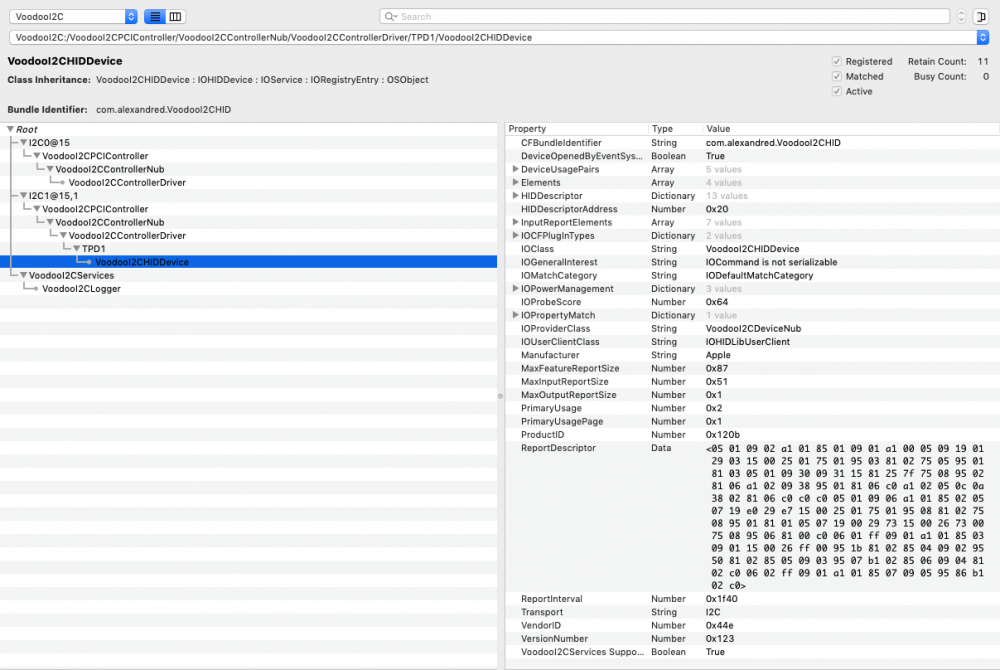

Nancy10 Posted May 16, 2019 Author Share Posted May 16, 2019 ah, so there is a good chance that the trackpad I2C kext from the 7490 would also work on the 7480 ? can you refer me to where it exists ? Link to comment Share on other sites More sharing options...
Administrators Hervé Posted May 16, 2019 Administrators Share Posted May 16, 2019 They're in the Clover pack available in my 7490 guide. What are the PCI ids of the TouchPad/TrackPoint models fitted to your 7480? On the 7490: TouchPad = 1028:081c (Dell-renamed Alps) TrackPoint = 044e:1212 (Alps) 1 Link to comment Share on other sites More sharing options...

Nancy10 Posted May 18, 2019 Author Share Posted May 18, 2019 I couldn't find it in the IOReg, I did attach debug files if you can find it for me. thanks. 853.zip Link to comment Share on other sites More sharing options...
Administrators Hervé Posted May 18, 2019 Administrators Share Posted May 18, 2019 Look under the various I2C devices... 1 Link to comment Share on other sites More sharing options...
Nancy10 Posted May 30, 2019 Author Share Posted May 30, 2019 On 5/18/2019 at 4:34 PM, Hervé said: Look under the various I2C devices... I know this I late, but I just go the time to look this up again, I found this device in the VoodooI2C devices, can you help me spot the PCI id form this ? Link to comment Share on other sites More sharing options...
Administrators Bronxteck Posted May 31, 2019 Administrators Share Posted May 31, 2019 ALPS I2c U1 / T4 Vender ID 0x044E Product ID 0x120B Version ID 0x0123 1 Link to comment Share on other sites More sharing options...

Nancy10 Posted May 31, 2019 Author Share Posted May 31, 2019 2 hours ago, Bronxteck said: ALPS I2c U1 / T4 Vender ID 0x044E Product ID 0x120B Version ID 0x0123 Thanks, but which one is the PCI ID that Hervé asked me for ? On 5/16/2019 at 2:07 PM, Hervé said: They're in the Clover pack available in my 7490 guide. What are the PCI ids of the TouchPad/TrackPoint models fitted to your 7480? On the 7490: TouchPad = 1028:081c (Dell-renamed Alps) TrackPoint = 044e:1212 (Alps) Link to comment Share on other sites More sharing options...
