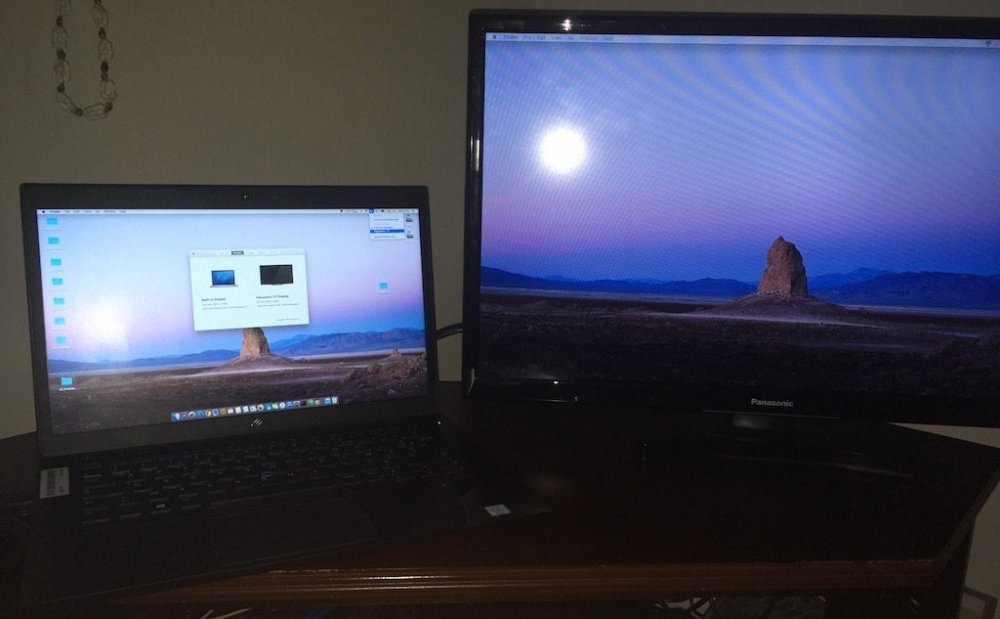

Tubardus Posted October 4, 2019 Share Posted October 4, 2019 This thread is about an issue of the HDMI output on a latitude 7490. It first began in this thread. As @Hervé said, it is "like covered with a veil and can't be removed even when playing with display colour settings." @Jake Lo asked me for the debug files when the motor is connected. Here it is.debug_30752.zip Link to comment Share on other sites More sharing options...

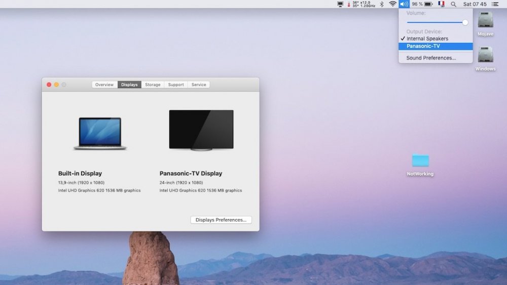

Tubardus Posted October 4, 2019 Author Share Posted October 4, 2019 Waw. I replaced your fixed config.plist. It works fine! How did you do??? Thanks a lot! Link to comment Share on other sites More sharing options...
Moderators Jake Lo Posted October 4, 2019 Moderators Share Posted October 4, 2019 Just add the HDMI patch even though HDMI connection works OOB, sometime it still causes issue you mentioned. Link to comment Share on other sites More sharing options...

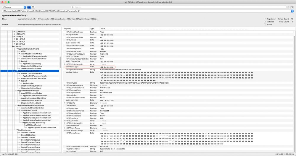

Administrators Hervé Posted October 5, 2019 Administrators Share Posted October 5, 2019 I've tried several mods of layout ids (ig-platform-id) and/or SMBIOS without success. At the same time, I no longer have any HDMI audio output available so it's like HDMI is not recognised per sé. Time to look up the IOReg. Link to comment Share on other sites More sharing options...
Administrators Hervé Posted October 5, 2019 Administrators Share Posted October 5, 2019 Yup, that what it seems to be: IOReg shows DP connector type when it should be HDMI; could be the reason and there certainly can be no harm trying to inject HDMI properties again. Link to comment Share on other sites More sharing options...
Administrators Hervé Posted October 5, 2019 Administrators Share Posted October 5, 2019 Spot on Jake. With HDMI connector-type properties injection, HDMI output is back to normal and HDMI-audio recovered. I've updated the bootpack of my Latitude 7490 guide to that affect. Link to comment Share on other sites More sharing options...
