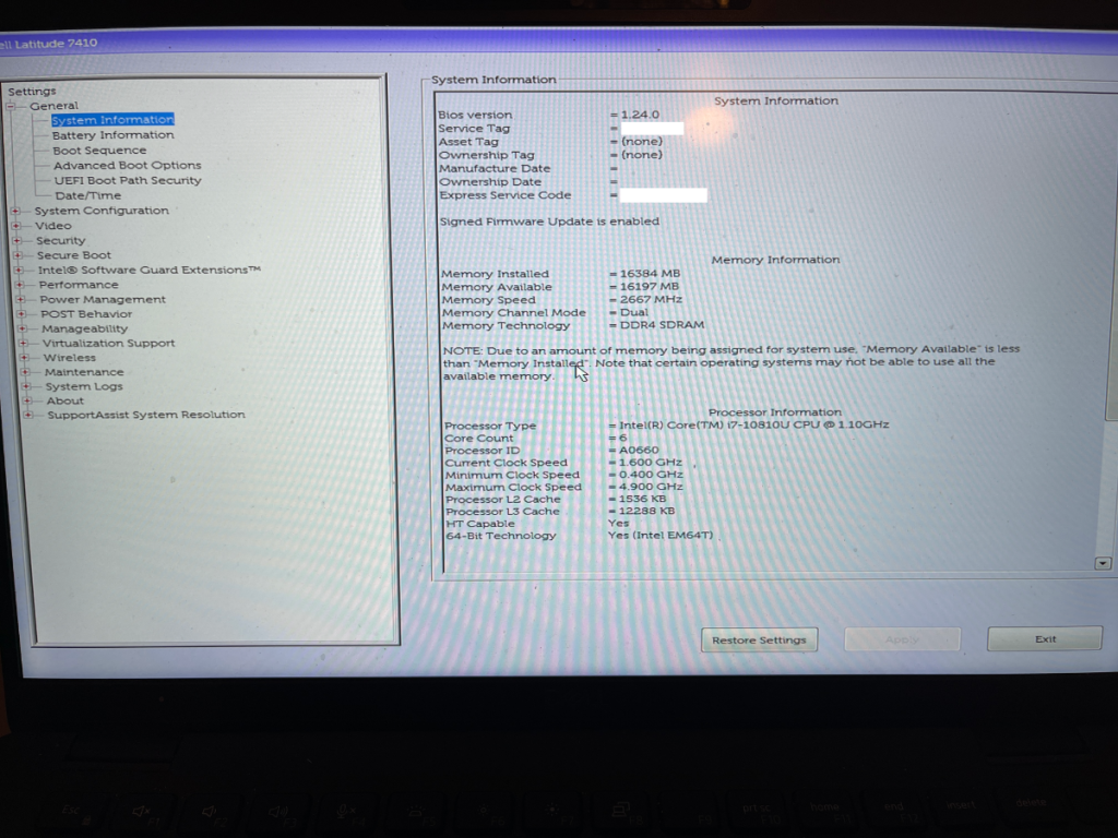

Interesting.  I think that's the same BIOS although mine is not a 2-in-1 machine.  I know the hynix HD is incompatible with MacOS, so I swapped this out with a Samsung 970 Pro that I had working on a desktop Hackintosh.
Did you make any HW changes before the install, such as the WiFi?  I didn't think anything like this would stop the installer from running.
How about BIOS settings?  Again, I think I have everything set correctly but, do you know what you had to configure?IMG_6204.thumb.png.f26afd7d3f8a15b64d34714d2edd6a64.png
