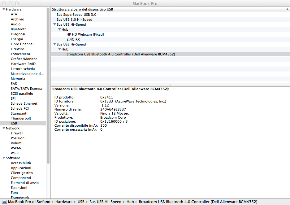

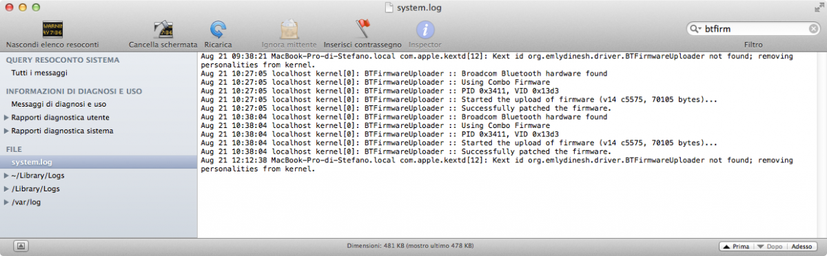

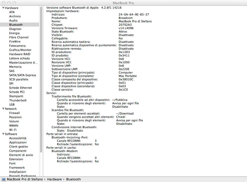

EMlyDinEsH Posted August 21, 2014 Author Share Posted August 21, 2014 Hi EMlyDinEsh, I have bought a BCM94352HMB combo Wifi+BT card and I have been reading and searching articles to make it fully work. The Wifi works perfectly with the toleda's BCM4352.kext, however, I am still having troubles with the Bluetooth. I have installed your kext and I know it successfully loaded in the system.log, but in system profiler, "connectable" shows "No" and "discoverable" shows "off". Tried to pair a Magic Mouse but the bluetooth manager just keep searching. I am so frustrated now after hours of try! Attached are the IOReg and the screenshoots of the system profiler, please take a look into it and I hope you could kindly help with this common problem on a combo card. Try to delete the com.apple.Bluetooth.plist from /Library/Preferences and reboot then try to pair from Notebook (as there is a bug in visibility with OSX driver which sometimes doesn't show itself). PM me so i can give you new build i've been working on so you can try. EDIT: Seems like your firmware was not updated to new one as i can see from the picture which is still v4096, thats why it was not working properly. Lets try the new build and send me your system log from Console app for each so i can check. Link to comment Share on other sites More sharing options...

meattattat Posted August 22, 2014 Share Posted August 22, 2014 Try to delete the com.apple.Bluetooth.plist from /Library/Preferences and reboot then try to pair from Notebook (as there is a bug in visibility with OSX driver which sometimes doesn't show itself). PM me so i can give you new build i've been working on so you can try. EDIT: Seems like your firmware was not updated to new one as i can see from the picture which is still v4096, thats why it was not working properly. Lets try the new build and send me your system log from Console app for each so i can check. Deleted the com.apple.Bluetooth.plist and reboot but still no luck, even with a brand new magic trackpad. Please send me the latest build for a try Link to comment Share on other sites More sharing options...
