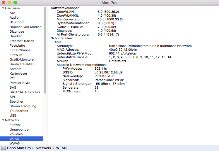

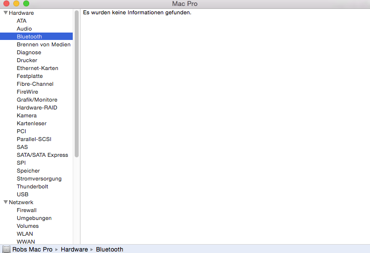

Hello,
need help with my Azurewave ce123h Bluetooth. Yesterday I installed Yosemite with Ozmosis. Everything is working fine. Then I installed Toledas bcm4352 kext, bcm4352bt + btfirmwareuploader v2.6 and Wifi and BT was working perfectly.
2 hours later BT stopped pairing mighty mouse. I tried several things but nothing worked to re-pair it. Therefore I reinstalled Yosemite.
Now BT isn't working at all. Could not see it in system information. Tried to reinstall all kexts but without success. Then I migrated a backup, now I can see the BT symbol but BT is still away from system information.
Please, any advice what I have to look for?
With Mavericks this card worked fine too, but pairing did`t work unless I disabled XHCI-Handoff in Bios. Therefore I tried the same for my current setup without success.
Thanks
