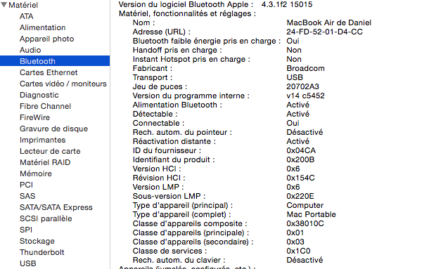

girardpallet Posted November 14, 2014 Share Posted November 14, 2014 Can you PM me details and System log when it shows up as 4096 instead 5546? Hello, sometime the firmware is "V14 C4096" and i can't use Bluetooth ! and sometime the firmware is "v14 c5590" and everything is working correctly , mouse, airdrop... copy of USB info with firmware c5590 : Broadcom USB Bluetooth 4.0 Controller (LiteOn BCM4352 BT) : Identifiant du produit : 0x200b Identifiant du fournisseur : 0x04ca (Lite-On Technology Corp.) Version : 1.12 Numéro de série : 24FD5201D4CC Vitesse : Jusqu’à 12 Mb/s Fabricant : Broadcom Corp Identifiant de l’emplacement : 0x1d130000 / 4 Courant disponible (mA) : 500 Courant requis (mA) : 0 Intégré : Oui How to force start with the correct firmware version , if possible ? Thank edit 1: finally, i use BTfirmwareUploader v2.3 with Firmware=3 and now is loading everytime firmware "V14 c5452" and BT work correctly .take 6 seconds to wakeup BT after sleep. V 2.6 didn't work for me ! is loading "V14 C4096" most of time and can not pair devices. if someone know how to force V14 C5590 in V2.6 , please let me know ! thank for your support Link to comment Share on other sites More sharing options...

girardpallet Posted November 21, 2014 Share Posted November 21, 2014 Hello, sometime the firmware is "V14 C4096" and i can't use Bluetooth ! and sometime the firmware is "v14 c5590" and everything is working correctly , mouse, airdrop... copy of USB info with firmware c5590 : Broadcom USB Bluetooth 4.0 Controller (LiteOn BCM4352 BT) : Identifiant du produit : 0x200b Identifiant du fournisseur : 0x04ca (Lite-On Technology Corp.) Version : 1.12 Numéro de série : 24FD5201D4CC Vitesse : Jusqu’à 12 Mb/s Fabricant : Broadcom Corp Identifiant de l’emplacement : 0x1d130000 / 4 Courant disponible (mA) : 500 Courant requis (mA) : 0 Intégré : Oui How to force start with the correct firmware version , if possible ? Thank edit 1: finally, i use BTfirmwareUploader v2.3 with Firmware=3 and now is loading everytime firmware "V14 c5452" and BT work correctly .take 6 seconds to wakeup BT after sleep. V 2.6 didn't work for me ! is loading "V14 C4096" most of time and can not pair devices. if someone know how to force V14 C5590 in V2.6 , please let me know ! thank for your support Link to comment Share on other sites More sharing options...
