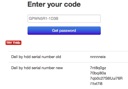

brutus.puente Posted January 1, 2016 Author Share Posted January 1, 2016 Okay, so I am able to access the BIOS I just can't make setting changes without the Admin Password for my E6420 GPWN5R1-1D3B. Below are my settings in my BIOS. Since my SATA Operation is set to RAID I'm assuming that is the reason why I cannot install an OSX to my hard drive. SATA Operation: Not Selected - Disabled Not Selected - ATA Not Selected - AHCI Selected - RAID On Boot Sequence: Not Checked - Diskette Drive Checked - Internal HDD (IRRT) Checked - USB Storage Device Checked - CD/DVD/CR-RW Drive Checked - Onboard NIC Boot List Option: Selected - Legacy Not Selected - UEFI I tried installing the new updated BIOS A22 as I am currently on A21 thinking this might wipe out the password, but still need the Admin Password to run this update. I generated a few suggested passwords from https://bios-pw.org/ but none would work. I also contacted Dell but the warranty was expired so they could not help without charging me a fee, to be honest I don't think the rep knew what she needed to do. I'm thinking the only way to move forward is to pay for a password from one of the sites below. I just hope they are legit. Has anyone used them before and if so which of the two would you recommend? www.pwd4bios.com/ www.biospassword.eu/buy-passwords/dell-instant-1d3b/ Thanks for everyone's feedback! Link to comment Share on other sites More sharing options...
Administrators Hervé Posted January 1, 2016 Administrators Share Posted January 1, 2016 RAID mode won't do so, yes, you'll have to get the BIOS password either from Dell or from those sites. You've got no other choices I'm afraid. Link to comment Share on other sites More sharing options...
Administrators Bronxteck Posted January 1, 2016 Administrators Share Posted January 1, 2016 try some of those passwords Link to comment Share on other sites More sharing options...
