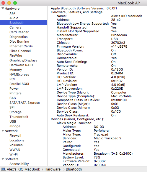

  • BT4LE - Handoff (I'm missing something here..) - BT Hotspot
  • Shows as AirPort Extreme card type
Handoff/Continuity is not completing but I think I'm missing something else... maybe iCloud configurations...

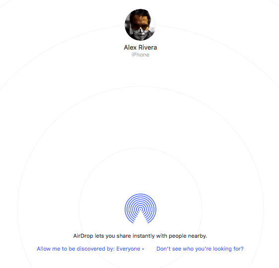

AirDrop is working with this card, and it's really fast :)
