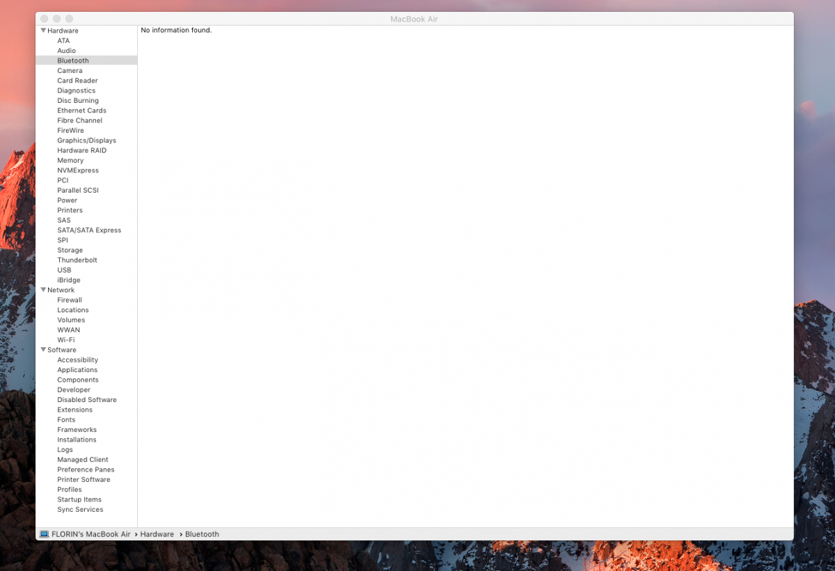

Dell_lover Posted May 13, 2017 Share Posted May 13, 2017 Hello, Im on Sierra 12.0.4. on my Dell Latitude E7450. WiFi is working with my BCM 43xx but it does not show me any Bluetooth informations. How can I get it to run and use my AirPods and Instant Hotspot with it? Link to comment Share on other sites More sharing options...

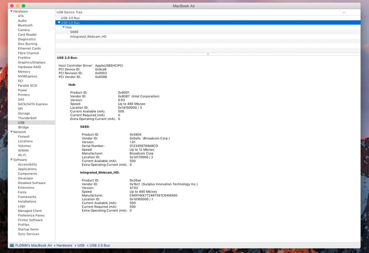

Moderators Jake Lo Posted May 13, 2017 Moderators Share Posted May 13, 2017 What's the exact model of your Wireless / Bluetooth device? Does bluetooth show up under USB? What kexts / patches do you have installed? Post Clover folder for further examination. Link to comment Share on other sites More sharing options...

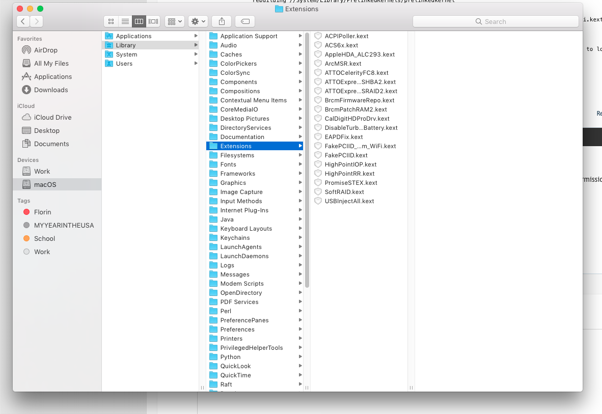

Dell_lover Posted May 14, 2017 Author Share Posted May 14, 2017 I'm using the DW1560 (BCM94352Z). Link to comment Share on other sites More sharing options...
seeker_pl Posted May 17, 2017 Share Posted May 17, 2017 make sure you have installed in /L/E: FakePCIID.kext FacePCIID_Broadcom_WiFi.kext BrcmPatchRam2.kext BrcmFirmwareRepo.kext rebuild permission, do it all over until you will get no errors: sudo chmod -Rf 755 /L*/E* sudo chown -Rf 0:0 /L*/E* sudo touch -f /L*/E* sudo chmod -Rf 755 /S*/L*/E* sudo chown -Rf 0:0 /S*/L*/E* sudo touch -f /S*/L*/E* sudo kextcache -Boot -U / I had to repaet it 8 times! If you still got errors try repeat touch and use: sudo touch -f /L*/E* sudo touch -f /S*/L*/E* sudo kextcache -system-prelinked-kernel or sudo touch /System/Library/Extensions && sudo kextcache -u / use config.plist from latest SIerra bootpack for e7450 https://osxlatitude.com/index.php?app=core&module=attach§ion=attach&attach_id=12017 Reboot Link to comment Share on other sites More sharing options...
Dell_lover Posted May 18, 2017 Author Share Posted May 18, 2017 Sorry - doesn't seem to work... FLORINs-MacBook-Air:~ officialflorint$ sudo chmod -Rf 755 /L*/E* FLORINs-MacBook-Air:~ officialflorint$ sudo chown -Rf 0:0 /L*/E* FLORINs-MacBook-Air:~ officialflorint$ sudo touch -f /L*/E* FLORINs-MacBook-Air:~ officialflorint$ sudo chmod -Rf 755 /S*/L*/E* FLORINs-MacBook-Air:~ officialflorint$ sudo chown -Rf 0:0 /S*/L*/E* FLORINs-MacBook-Air:~ officialflorint$ sudo touch -f /S*/L*/E* FLORINs-MacBook-Air:~ officialflorint$ sudo kextcache -Boot -U / rebuilding //System/Library/PrelinkedKernels/prelinkedkernel kext-dev-mode allowing invalid signature -67062 0xFFFFFFFFFFFEFA0A for kext USBInjectAll.kext kext-dev-mode allowing invalid signature -67062 0xFFFFFFFFFFFEFA0A for kext FakePCIID_Broadcom_WiFi.kext kext-dev-mode allowing invalid signature -67062 0xFFFFFFFFFFFEFA0A for kext FakePCIID.kext kext-dev-mode allowing invalid signature -67062 0xFFFFFFFFFFFEFA0A for kext EAPDFix.kext kext file:///Library/Extensions/DisableTurboBoostBattery.kext/ is in hash exception list, allowing to load kext-dev-mode allowing invalid signature -67030 0xFFFFFFFFFFFEFA2A for kext AppleHDA_ALC293.kext kext-dev-mode allowing invalid signature -67062 0xFFFFFFFFFFFEFA0A for kext ACPIPoller.kext Link to comment Share on other sites More sharing options...

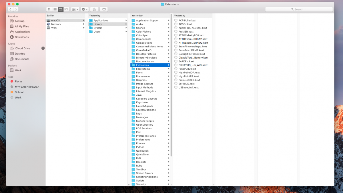

seeker_pl Posted May 18, 2017 Share Posted May 18, 2017 BrcmPatchRam2.kext and BrcmFirmwareRepo.kext are missing. Check if they are in L/E and rebuild permission. If you have a proper kext to patches in your config you should get WiFi working and Bluetooth. Link to comment Share on other sites More sharing options...
Dell_lover Posted May 19, 2017 Author Share Posted May 19, 2017 its there isn't it.? Link to comment Share on other sites More sharing options...
Moderators Jake Lo Posted May 19, 2017 Moderators Share Posted May 19, 2017 Rerun the commands again until you see those kexts in the output. Reboot and rerun if necessary. 1 Link to comment Share on other sites More sharing options...
