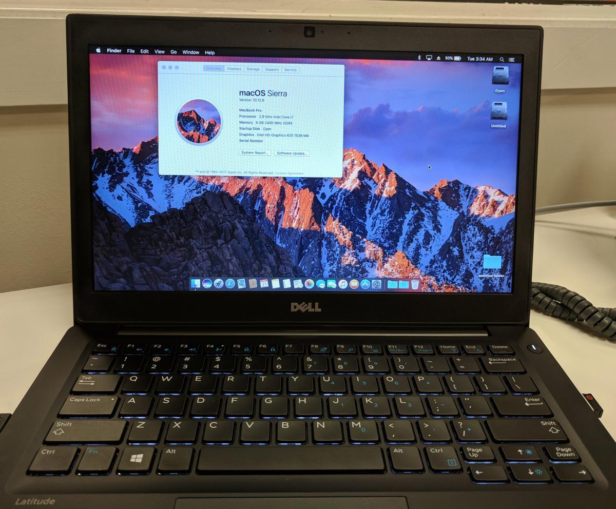

abraxis Posted November 21, 2017 Author Share Posted November 21, 2017 Try replacing this to /EFI/Clover This worked great ! Thank you Any advice on sound trackpad and keyboard? Link to comment Share on other sites More sharing options...
Moderators Jake Lo Posted November 21, 2017 Moderators Share Posted November 21, 2017 Copy kexts from /EFI/Clover/kexts/Other /LE to /Library/Extensions Repair permissions and rebuild cache sudo chmod -Rf 755 /L*/E* sudo chown -Rf 0:0 /L*/E* sudo touch -f /L*/E* sudo chmod -Rf 755 /S*/L*/E* sudo chown -Rf 0:0 /S*/L*/E* sudo touch -f /S*/L*/E* sudo kextcache -Boot -U / Reboot to Clover GUI, hit F4 on the keyboard, Continue booting to OS X . See if Audio is working. So both keyboard and trackpad are not working? Follow instructions from here to debug issue 1 Link to comment Share on other sites More sharing options...

Moderators Jake Lo Posted November 21, 2017 Moderators Share Posted November 21, 2017 remove these from /S/L/E, repair permission and rebuild cache AppleHPM.kext, AppleIntelLpssI2C.kext and AppleIntelLpssI2CController.kext Reboot. Download the attached, change permission and load the kext manually See if touchpad works. sudo chown -R root:wheel VoodooI2C.kext sudo kextload VoodooI2C.kext VoodooI2C.kext.zip 1 Link to comment Share on other sites More sharing options...
