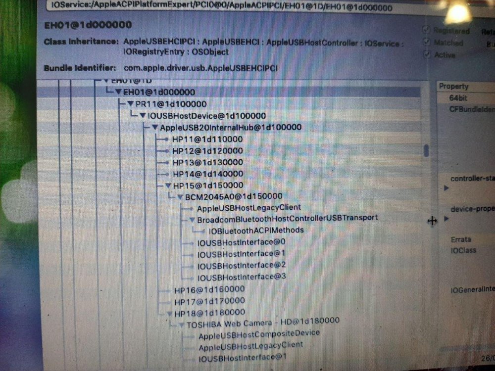

Azrul Haifan Posted July 27, 2019 Share Posted July 27, 2019 I have installed DW1820A that seems wrong labeled as OVW3T3, because it's subsystem ID showing up as 1028:0023. The wifi is working fine, even without airportbrcmfixup, but the bluetooth is not detected at all. i've usb working, installed usbinjectall, and implemented custom ssdt. even if i'm removing custom ssdt, the bluetooth device won't show up. Than i'm doing the pin masking like @Naidis did, and than my wifi card is unavailable, but the bluetooth device is appear. the bluetooth it self have BCM2045A0 detected with Vendor ID : 0A5C, and product ID : 6412, the location of usb port is on HP13, that mean the bluetooth device using USB 2 BUS, on PR11, like this Reveal hidden contents The conclusion is, 1. If my pin card is masked, the bluetooth detected, but it make wifi unavailable 2. if my pin card is not masked, the bluetooth is not detected at all, and wifi work normally i don't know it's my card problem, or my ngff slot hardware problem, becasue it have same case on windows. Anybody please help me out i'm attached my IOReg without pin masking for now Azrul’s MacBook Pro WPM.ioregFetching info... Link to comment Share on other sites More sharing options...
muttonhead411 Posted July 28, 2019 Author Share Posted July 28, 2019 A few questions for you... how does the device work on windows with pin masked and not masked? If they work normally then it’s more than likely a configuration issue on your Hackintosh. also Herve mentioned before that the functiontionality of wifi and Bluetooth are different. All DW1820A will have Bluetooth detected as long as you have rehabman kext loaded. Getting Bluetooth usable with a connected device is the tricky one. Pin masking is required for your version of card to work with WiFi. Link to comment Share on other sites More sharing options...
