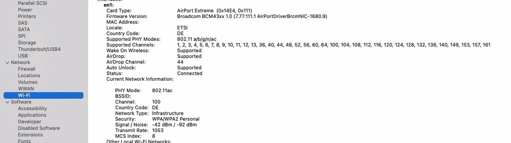

Administrators Hervé Posted May 10, 2022 Administrators Share Posted May 10, 2022 Check what SysInfo->Wifi reports in terms of reported connection speed and channel. It's probably worth experimenting with some of those AirportBrcmFixup boot args such as brcmfx-country=#a. https://github.com/acidanthera/AirportBrcmFixup Link to comment Share on other sites More sharing options...
gemino Posted May 23, 2022 Author Share Posted May 23, 2022 Thanks @Hervé and @Jazzoo I gave up on the Broadcom card - managed to get 480Mbps tops. I have reinstalled the intel card and have 650Mbps easily without any special patches or tweaks. Since I don't use Bluetooth at all - this setup works for me. Many thanks! I now have a fully working Dell 7490 Hackintosh with Monterey! All works beautifully, especially sleep, USB C port with a docking station and DisplayLink, etc. Amazing stuff! Thanks again! 1 Link to comment Share on other sites More sharing options...
