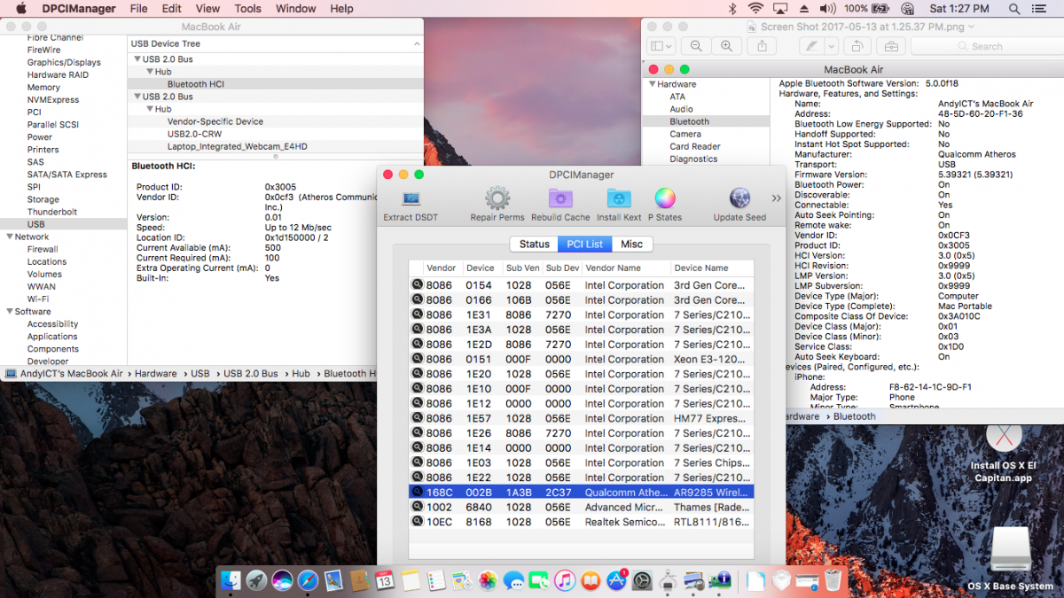

andyict Posted May 13, 2017 Share Posted May 13, 2017 hi guys! can help me. dell vostro 3560 10.12 ar5b195(VID: 0cf3 PID: 3005) has enabler wifi and bluetooth but only connect hostport from Mac-to-iphone! also can't pair help me pls. DSDT+iotrg.zip Link to comment Share on other sites More sharing options...
