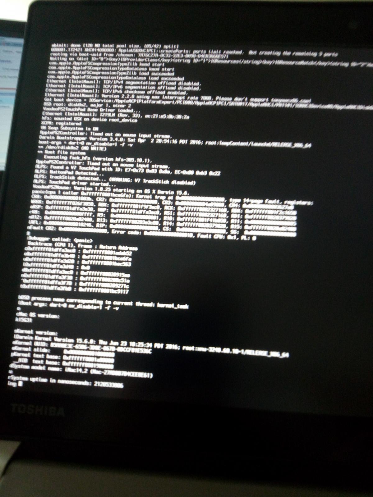

gsalem Posted May 23, 2017 Share Posted May 23, 2017 Hi, It's me again, with my tecra z40. I found in the different posts different versions of the binaries, all of them would crash (kernel panic). My dmesg gives this ApplePS2ALPSGlidePoint::identify: Found ALPS Device with ID E7=0x73 0x03 0x0a, EC=0x88 0xb3 0x22 ApplePS2ALPSGlidePoint::identify: vanquybn your device here ID E7=0x73 0x03 0x0a, EC=0x88 0xb3 0x22 ApplePS2ALPSGlidePoint EC Report: { 0x88, 0xb3, 0x22 } ApplePS2ALPSGlidePoint::identify: ALPS vanquybn type 3 ApplePS2ALPSGlidePoint EC Report: { 0x88, 0xb3, 0x22 } ApplePS2ALPSGlidePoint: Device initialization failed. Touchpad probably won't work That's all I see from dmesg. update: Thanks Jake for the pointer. It gives a KP Here's a photo of the KP. thanks again Link to comment Share on other sites More sharing options...
Moderators Jake Lo Posted May 23, 2017 Moderators Share Posted May 23, 2017 Do you have another version of VoodooPS2Controller in another folder? KP shows 1.8.25. Link to comment Share on other sites More sharing options...
gsalem Posted May 23, 2017 Share Posted May 23, 2017 Jake, You're fantastic man! In fact, I had a kext in the hidden EFI partition, that I renamed to VoodooPS2Controller.kext.old, but it seems Clover loads it anyway. So I removed it, and now it works. Brilliant work from Dr Hurt and yourself (and all the other contributors). Best regards Link to comment Share on other sites More sharing options...
