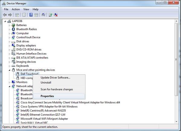

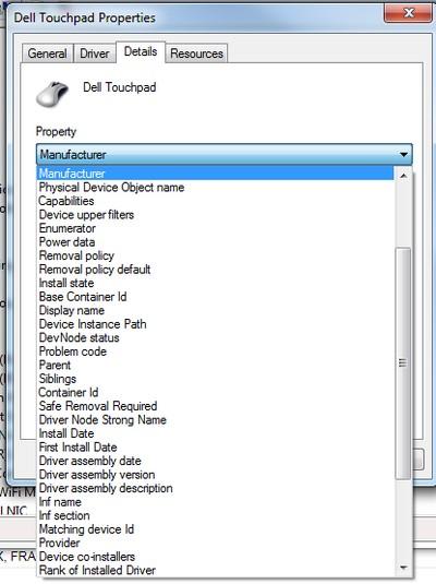

Administrators Hervé Posted October 24, 2017 Administrators Share Posted October 24, 2017 Open up Device Manager and look into the various info listed in the touchpad device Properties->Details tab... Example (not from an E5430): Don't hesitate to browse through all the listed info for hints. Of course, you should first consult the Dell online support web site, especially the documentation and/or the drivers for your model. Stating the obvious but most people don't even think about it... Oh, look! http://www.dell.com/support/home/us/en/19/product-support/product/latitude-e5430/drivers 1 Link to comment Share on other sites More sharing options...
