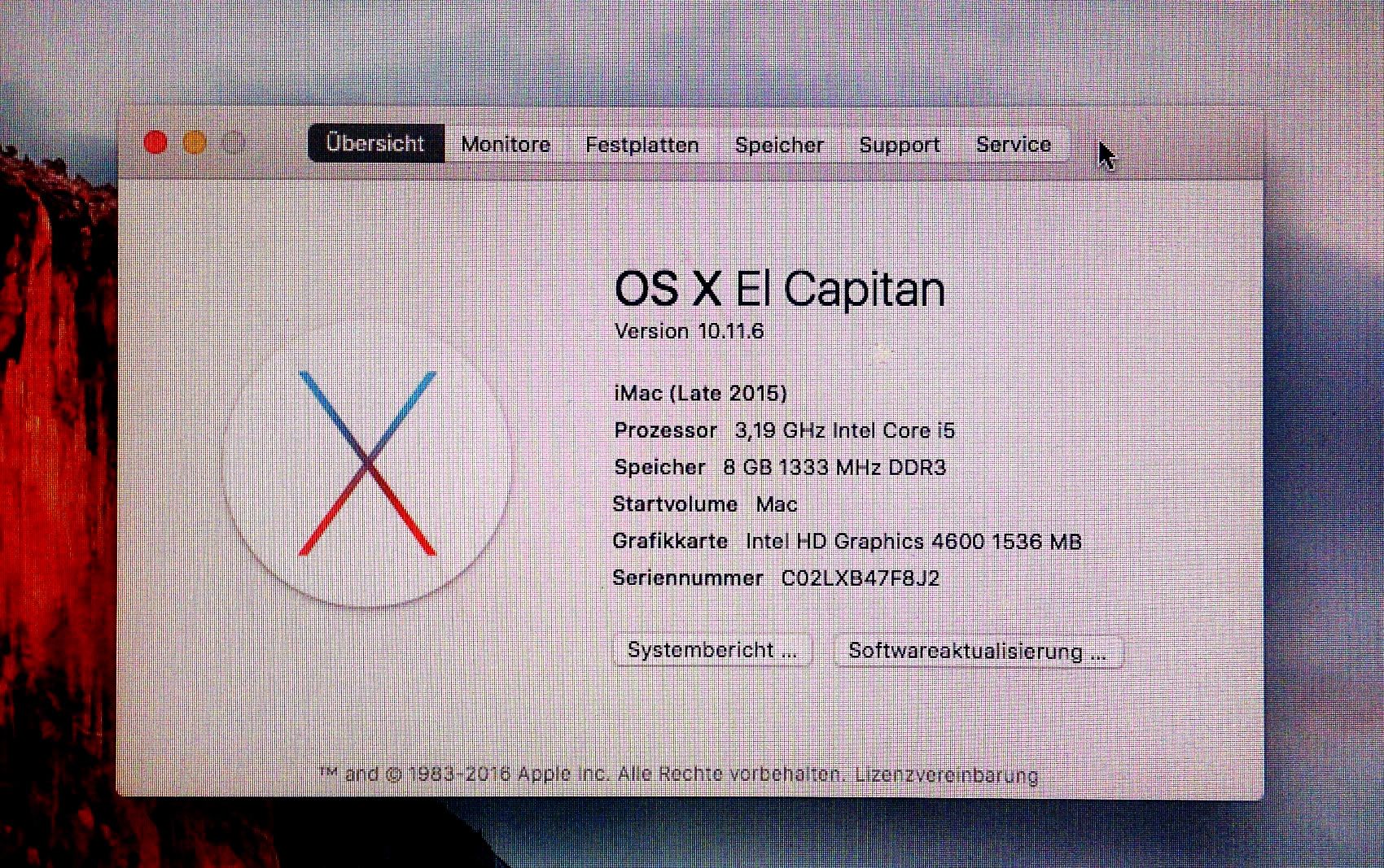

ioncatana Posted August 24, 2016 Share Posted August 24, 2016 I have tried the following Clover settings with the Intel HD 4600: a) IntelGFX: 0x01428086 / ig-platform-id: 0x0d220003 / InjectIntel: TRUE => right after "PPGTT is enabled" comes the black screen IntelGFX: <empty> / ig-platform-id: 0x0d220003 / InjectIntel: TRUE => right after "PPGTT is enabled" comes the black screen c) IntelGFX: <empty> / ig-platform-id: 0x0d220003 / InjectIntel: FALSE => stuck at "PPGTT is enabled" ( so no black screen appears ) d) IntelGFX: <empty> / ig-platform-id: <empty> / InjectIntel: TRUE => right after "PPGTT is enabled" comes the black screen e) IntelGFX: 0x01428086 / ig-platform-id: <empty> / InjectIntel: TRUE => right after "PPGTT is enabled" comes the black screen f) IntelGFX: 0x11428086 / ig-platform-id: <empty> / InjectIntel: TRUE => works without QE/CI ( IMPORANT: the GFX-id is a non existing id, u can take anything you like, it works also with 0xABCD8086, where ABCD is a non existing ID ) Probably the Azul-Kext file needs a patch for the 10.11.5 Any help in this matter is really appreciated Link to comment Share on other sites More sharing options...
Administrators Hervé Posted August 24, 2016 Administrators Share Posted August 24, 2016 Correct me if I'm wrong or aren't all your above ids incorrect? Desktop HD4600 is vendor 8086 (Intel) -not 8085- and device 0412. As such, I believe the IntelGFX parameter should have been set to 0x04128086. No Azul FB kext patching would normally be required to get QE/CI unless the default ports do not support/match your rig of course (but I'd be surprised). Link to comment Share on other sites More sharing options...

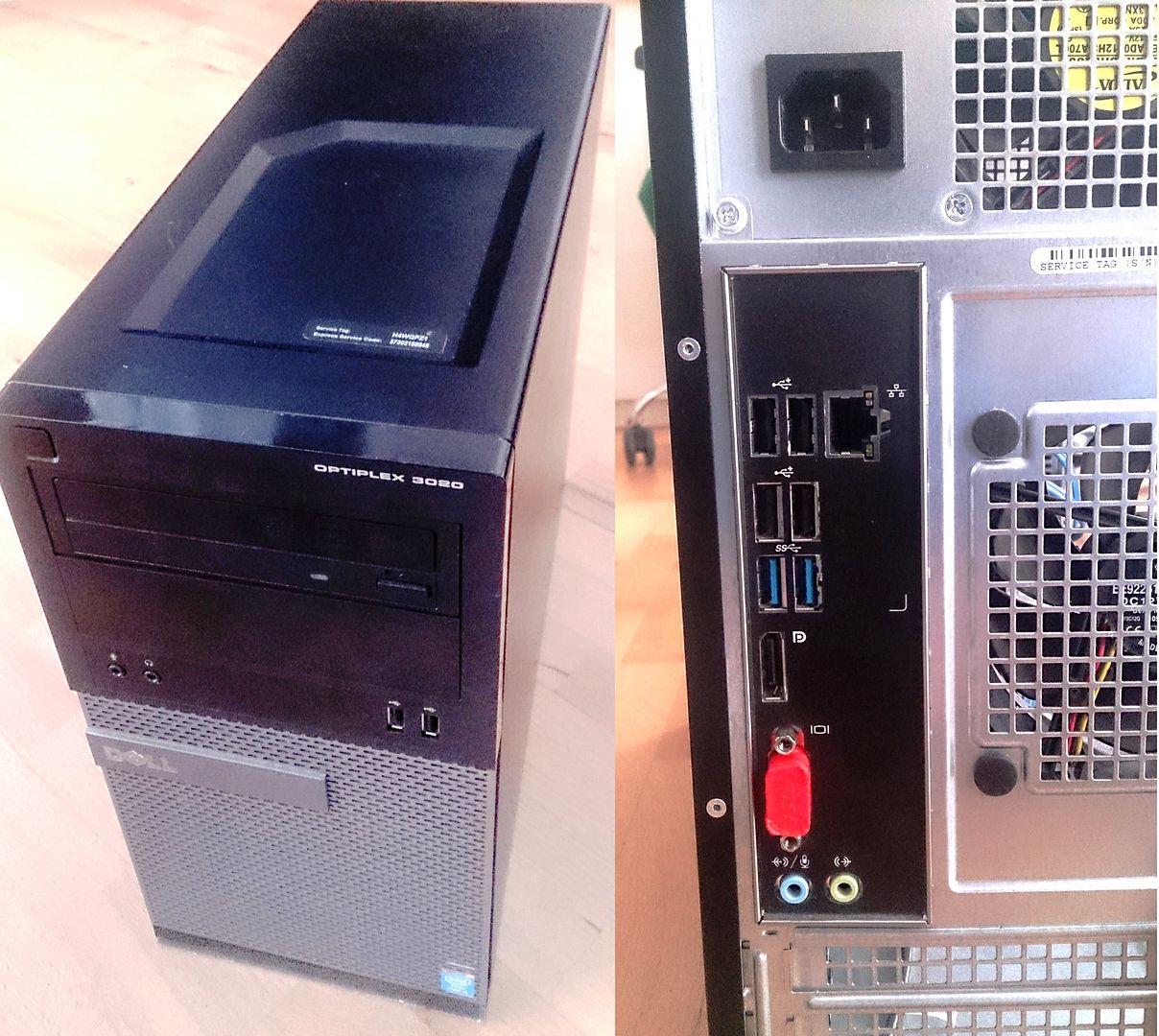

Moderators Jake Lo Posted August 24, 2016 Moderators Share Posted August 24, 2016 Go with B and you'll need to remove the ATI card. On my 9020, I used the Displayport. What connection does your 3020 have? Try replacing your _DSM Method under IGPU in SSDT-7 with this Method (_DSM, 4, NotSerialized) // _DSM: Device-Specific Method { If (LEqual (Arg2, Zero)) { Return (Buffer (One) { 0x03 }) } Return (Package (0x08) { "device-id", Buffer (0x04) { 0x12, 0x04, 0x00, 0x00 }, "AAPL,ig-platform-id", Buffer (0x04) { 0x03, 0x00, 0x22, 0x0D }, "hda-gfx", Buffer (0x0A) { "onboard-1" }, "model", Buffer (0x0E) { "Intel HD 4600" } }) } Link to comment Share on other sites More sharing options...

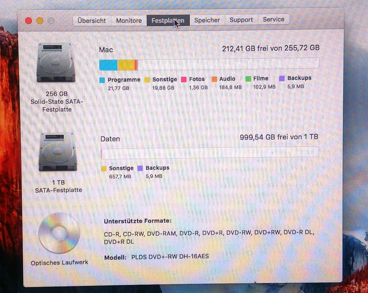

ioncatana Posted August 24, 2016 Share Posted August 24, 2016 Thank you Herve & Jake Lo for the support! It was the bloody VGA connector Yes it works with option and Displayport I have updated with success to 10.11.6 Everything works now Display, Audio, Ethernet Will upload the latest EFI-Config! Link to comment Share on other sites More sharing options...
