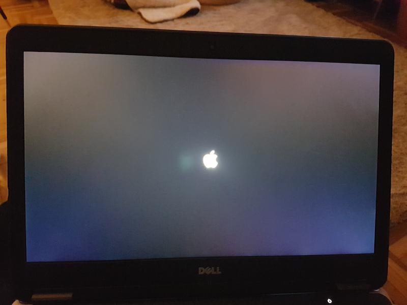

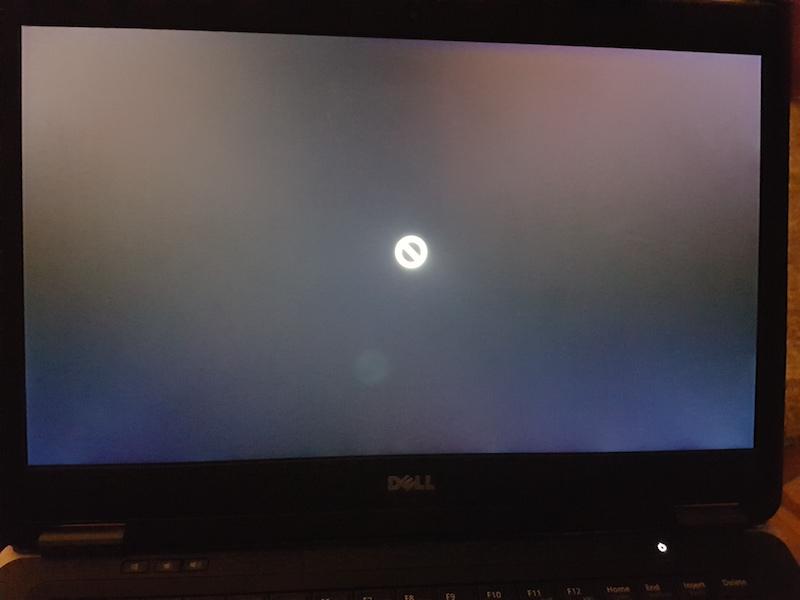

dctacsi Posted February 6, 2017 Share Posted February 6, 2017 Hello, You've seen the attached image problem occurs during installation. Component: Dell Latitude E7440 Mac OS X Sierra Clover 3998 Anyone have any ideas? Link to comment Share on other sites More sharing options...
Moderators Jake Lo Posted February 6, 2017 Moderators Share Posted February 6, 2017 Please use our native attachment feature by clicking on the "More Reply Options". I'm block from those links Link to comment Share on other sites More sharing options...
Administrators Hervé Posted February 6, 2017 Administrators Share Posted February 6, 2017 Images attached after duly downsizing (from 4000x3000 @3+MB to 800x600 @100KB). Boot in verbose mode to see where things hang. Link to comment Share on other sites More sharing options...

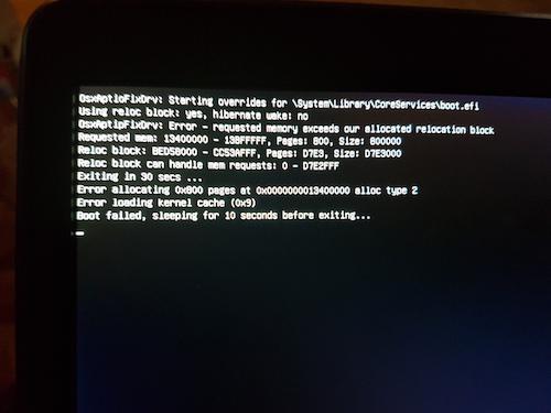

dctacsi Posted February 7, 2017 Author Share Posted February 7, 2017 Link to comment Share on other sites More sharing options...
Administrators Bronxteck Posted February 7, 2017 Administrators Share Posted February 7, 2017 try with this clover Clover_v2.4k_r4002.zip Link to comment Share on other sites More sharing options...

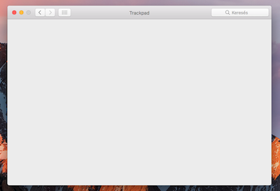

dctacsi Posted February 11, 2017 Author Share Posted February 11, 2017 Hi, Thank you very much for your help so far, almost all succeeded! If you do not care, now I'd give a quick description of how I installed it to see if anyone comes to see what is wrong ... The installation is done by: https://osxlatitude.com/index.php?/topic/8506-dell-latitude-inspiron-precision-clover-guide/ Part 1 USB setup was not creating a problem. The USB installer to create a "Clover_v2.4k_r4003" was used. The contents of the folder Clover I changed the content can be found at 37 Clover folder contained herein. Part 2 installation was no problem. The problems began in the third section! I installed the above mentioned Clover v2.4 r4003 EFI Mounter I did everything v3 EFI kext folder and copied files from USB Terminal I run the specified command TouchPad settings are empty! I can not produce anything! (Picture attached) Point 10 to the beginning everything was fine, but it could be the end, I am not well done! "Execute ssdtPRGen.sh from terminal (Included in Tools attached below) Place SSDT.aml generated in / EFI / Clover / ACPI / Patched " At this point, I opened a terminal SSDT.aml Tools folder file on your terminal opened in pushing through Y when asked. The "Desktop" generated files are copied to the specified location (ie / EFI / Clover / ACPI / Patch) In addition, I found the TouchPad on which one has not worked something. When it started the machine, you will start to Clover, I click on it the Macintosh SSD, but unfortunately nothing happens only black screen is ... If someone's idea would be looking forward to your answers! Welcome, Balázs Soos Link to comment Share on other sites More sharing options...
Administrators Hervé Posted February 11, 2017 Administrators Share Posted February 11, 2017 Lookup the 10.11.6 TouchPad PrefPane in Dr Hurt's PS2Controller thread and run his execution script at login time. Link to comment Share on other sites More sharing options...
