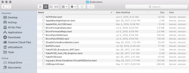

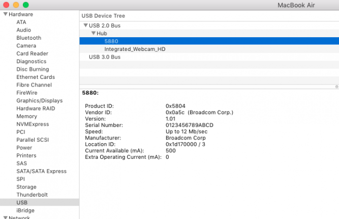

Dell_lover Posted May 29, 2017 Author Share Posted May 29, 2017 Card is set to the right slot. It is enabled and shown in the BIOS... Yes, its in USB. See the screenshot Link to comment Share on other sites More sharing options...
Administrators Hervé Posted May 29, 2017 Administrators Share Posted May 29, 2017 You're quite mistaken! Broadcom device 5880 is no Bluetooth module. It's a SoC used for security purposes. https://www.broadcom.com/products/embedded-and-networking-processors/secure/bcm5880 https://blog.g3rt.nl/enable-dell-nfc-contactless-reader.html Your DW1560 is either not in a WWAN slot (mandatory to get Bluetooth over USB) and/or your USB ports are not all functional (you would need to patch your DSDT to rename EHCx devices to EH0x and install a USB injector kext). Look up details of the DW1560 in the wikidevi link provided in our inventory thread. At the risk of sounding silly, are you sure you have a DW1560 or a combo Wifi/BT card? If you have a Bluetooth module and Bluetooth is enabled, BIOS information page should show something like "Bluetooth device = installed" next to Wifi and Cellular (=WWAN/3G-4G) devices. Link to comment Share on other sites More sharing options...

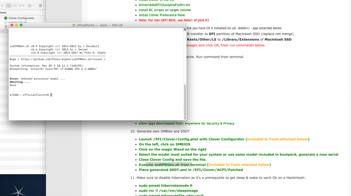

Dell_lover Posted May 30, 2017 Author Share Posted May 30, 2017 what is DSDT patching.. ? Link to comment Share on other sites More sharing options...
Dell_lover Posted May 30, 2017 Author Share Posted May 30, 2017 If this is what you mean - sorry. Not even that works Link to comment Share on other sites More sharing options...

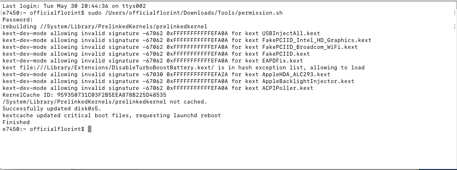

Dell_lover Posted May 30, 2017 Author Share Posted May 30, 2017 okay. looks like I've got it. Ill try to reboot and see... Link to comment Share on other sites More sharing options...
Dell_lover Posted May 30, 2017 Author Share Posted May 30, 2017 nope don't work. Link to comment Share on other sites More sharing options...
