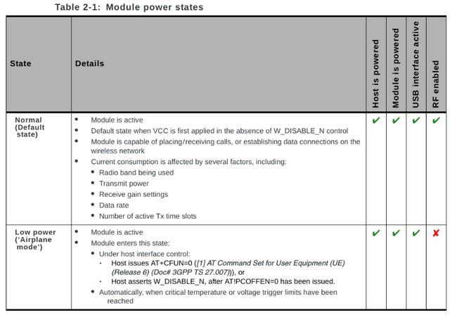

You'll find useful details on the MC8805 chip here. In particular, you'll probably find more meaningful to know that low power mode = Airplane mode. Now, if you look at table 2-1 on p9, you'll notice references to AT commands related to setting the modem in low power mode. It may well be that setting the values to 1 rather than 0 puts the modem back online:
Indeed, the table shows the W_DISABLE_N input line attached pin 20 (that pin again), so if it's taped, no assertion signal can normally be received on the modem to disable RF module. This is actually stated on p34 of that document:
This being said, we'd need to confirm that MC8805 follows the same pinout (which is highly likely) though there can be no harm in trying masking pin20 anyway. It's not as if it could burst the hosting laptop to flames. Or is it?  :mrgreen: I've not managed to find a copy of the AirPrime MC8805 Product Technical Specification Document & Customer Design Guidelines.
