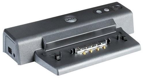

seb43654 Posted September 8, 2012 Share Posted September 8, 2012 Hi, I was thinking of getting the dock for the D630 and was wondering if all the ports worked on it? Also in the bios there is an option to use the dock video card - does this work? Thanks, Seb Link to comment Share on other sites More sharing options...
tman Posted September 17, 2012 Share Posted September 17, 2012 I have one and it works fantastic! I can leave my mouse plugged in, close the lid and when I resume the next day the mouse has power. When coming out of sleep and when not using a dock, the mouse has to be unplugged and plugged in again for the system to recognize it. I haven't tested the video though. Link to comment Share on other sites More sharing options...
tweakbsd Posted September 17, 2012 Share Posted September 17, 2012 I'm using the dock as well. Using it to watch Blu-Rays on my flat screen TV using DVI to HDMI adapter. Multi-Monitor support works like a charm. The only thing that doesn't work is the SPDIF-OUT whicht is due to no driver support. Even Hot-Pluggin in and out of the dock works in LION. ML not tried yet, but it should. But I'm working on a VoodooHDA.kext that will eventually support it someday in the far future cause I have not many spare time to spend on developing I/O Kit drivers. My son is now 7 weeks old and consumes my time Link to comment Share on other sites More sharing options...

novaman64 Posted March 6, 2013 Share Posted March 6, 2013 I'm using the dock as well. Using it to watch Blu-Rays on my flat screen TV using DVI to HDMI adapter.Multi-Monitor support works like a charm. The only thing that doesn't work is the SPDIF-OUT whicht is due to no driver support. Even Hot-Pluggin in and out of the dock works in LION. ML not tried yet, but it should. But I'm working on a VoodooHDA.kext that will eventually support it someday in the far future cause I have not many spare time to spend on developing I/O Kit drivers. My son is now 7 weeks old and consumes my time Was there anything special you needed to do to get dual monitor working? My current setup... Dell PR01X dock - One DVI and one VGA port Dell D630 Intel x3100 running 10.7.2 with most current EDP v5.1 rev 372, 8GB ram, SSD When I plug both my monitors into the dock, and turn the docked laptop on, it first shows me my bios and starts booting on the DVI display, then when it hits the login screen switches to the VGA screen. If I go into "Settings" and "Displays", and hit detect, it doesnt do anything... Thoughts? Link to comment Share on other sites More sharing options...
Administrators Hervé Posted March 6, 2013 Administrators Share Posted March 6, 2013 As mentioned several times before, the DVI port remains unsupported. <_> Link to comment Share on other sites More sharing options...
Skorpio Posted March 9, 2013 Share Posted March 9, 2013 Recently acquired by the dock and I'm very pleased. The monitor is connected to the DVI and works great. Dell 630 Nvidia. Link to comment Share on other sites More sharing options...
Administrators Hervé Posted March 9, 2013 Administrators Share Posted March 9, 2013 You must be the 1st person to report a working DVI port on a D6x0 docking station. Can you tell us more please (model of dock, method to get it to work, etc.)? Link to comment Share on other sites More sharing options...
Skorpio Posted March 10, 2013 Share Posted March 10, 2013 Docking model Dell PRO1 X for Adapter PA-10 and Dell D630 width Nvidia 135.The man who sold me did not even use it because it did not have the appropriate adapter PA-10. Monitor Fujitsu 22W6. For now it works flawlessly. I have had none methods. I just turned on and it works. Link to comment Share on other sites More sharing options...
