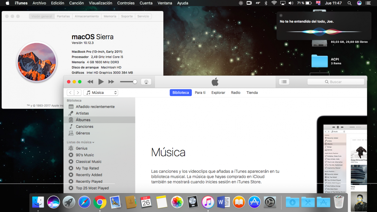

kosakgroove Posted January 26, 2017 Share Posted January 26, 2017 Hi friends, attached I post ioregs and system logs like Elmydynesh proposes, I am running on a Lenovo Thinkpad L420, Synaptics 7.2 i think Core i5, 4GB Ram, AR9285, OS: Clover bootloader and Mac OS Sierra 10.12.3 with your kext 4.7 beta 5 Mostly everything works properly, thing is that it works because I lowered the necessary pressure for 1 finger tap, but even the solid left and right keys of the trackpad only work if you press real hard... 2 finger tap and scrolling works nice but again, the pressure should be less you have to really drag those two fingers hard xD 3 finger up for Mission Control, 3 finger Left or Right Switch between desktops as I wanted which is really cool. I wonder if you could help and perfect that a little with the pressure. Also, double tapping for drag and 2 finger tap for right click doesnt work very well and the trackpoint (little red ball in the keyboard that is also a mouse) and the 3 corresponding buttons do not work. The main issue for me is that after sleep the trackpad starts working good like normal, but after a couple mouse strokes or gestures, it happens two things: Either the trackpad stops working and the keyboard remains on Either the computer does a sudden reboot after the trackpad stopped working So I am unable to use sleep with your kext ( that I love so much more than Vooodoo) Note that prior to the installation of your kext the computer slept like a charm. trackpad not working keyboard yes.zip trackpad working.zip Link to comment Share on other sites More sharing options...
