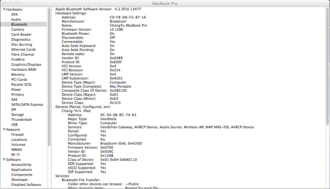

yuchen1211 Posted May 6, 2014 Share Posted May 6, 2014 Hi, I got an AzureWave Broadcom BCM94352HMB 802.11ac 867Mbps WLAN + BT4.0 Half Mini PCI-E and got the WIFI working My question is that if I just install the BTFirmwareUploader.kext v2.3 without editing anything then I can see the BT device info in the "system information" and the Bluetooth seems to be working(not sure because I don't have a bluetooth device in hand to test) But if I edit the two info.plist files to add idVendor/idProduct information following the instruction of the post, the BTFirmwareUploader.kext won't load and the Bluetooth service won't be available. Is there anything I'm missing? The following are the device info, ioreg file and screen shot of "system information" when BTFirmwareUploader.kext is loaded. Thanks USB Product Name, Foxconn-T77H114-BCM2070 idProduct, Number, 0xe00f idVendor, Number, 0x0489 Rev 0596 MacBook Pro.zip Link to comment Share on other sites More sharing options...
EMlyDinEsH Posted May 9, 2014 Author Share Posted May 9, 2014 Hi, I got an AzureWave Broadcom BCM94352HMB 802.11ac 867Mbps WLAN + BT4.0 Half Mini PCI-E and got the WIFI working My question is that if I just install the BTFirmwareUploader.kext v2.3 without editing anything then I can see the BT device info in the "system information" and the Bluetooth seems to be working(not sure because I don't have a bluetooth device in hand to test) But if I edit the two info.plist files to add idVendor/idProduct information following the instruction of the post, the BTFirmwareUploader.kext won't load and the Bluetooth service won't be available. Is there anything I'm missing? The following are the device info, ioreg file and screen shot of "system information" when BTFirmwareUploader.kext is loaded. Thanks USB Product Name, Foxconn-T77H114-BCM2070 idProduct, Number, 0xe00f idVendor, Number, 0x0489 Rev 0596 Screen Shot 2014-05-04 at 9.28.33 PM.png MacBook Pro.zip Your bluetooth doesn't require firmware patching. So, you don't need my driver but you need to add your device id's to Apple Broadcom bluetooth kext (or) use my BluetoothDevInfo kext with your id's. Link to comment Share on other sites More sharing options...
yuchen1211 Posted May 10, 2014 Share Posted May 10, 2014 Your bluetooth doesn't require firmware patching. So, you don't need my driver but you need to add your device id's to Apple Broadcom bluetooth kext (or) use my BluetoothDevInfo kext with your id's. I added the device's ID into IOBluetoothFamily.kext and remove BTFirmwareUploader.kext and BT works. Thanks for the info. Link to comment Share on other sites More sharing options...
