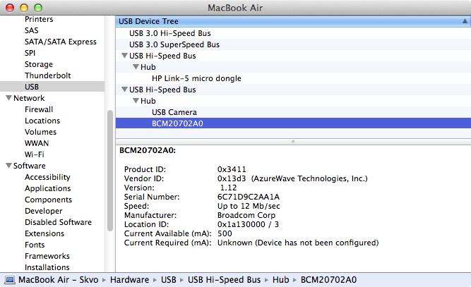

Skvo Posted June 21, 2014 Share Posted June 21, 2014 Bought AzureWave AW-CE123H (bcm94352hmb), was a new version (VID=13d3, PID=3411) BTFirmwareUploader v2.4 - does not recognize the module.Added values ​​manually - everything was working without any problem .. EMlyDinEsH, add new ID in the next version kext. Thank you... P.S: In the first post wrong. Identifiers confused. In the quotation highlighted in red: Supported Bluetooth Vendor and Product ID:Broadcom:VID: 13d3 PID: 3404 (Azurewave)VID: 0b05 PID: 17cf (Asus)VID: 413c PID: 8143 (Dell)VID: 04ca PID: 200a (LiteOn)VID: 04ca PID: 200b (LiteOnVID: 04ca PID: 200c (LiteOn) VID: 04ca PID: 200c (HP) VID: 04ca PID: 200c (Toshiba NGFF) Link to comment Share on other sites More sharing options...
EMlyDinEsH Posted June 24, 2014 Author Share Posted June 24, 2014 Bought AzureWave AW-CE123H (bcm94352hmb), was a new version (VID=13d3, PID=3411) Снимок Ñкрана 2014-06-21 в 17.00.22.png BTFirmwareUploader v2.4 - does not recognize the module. Added values ​​manually - everything was working without any problem .. EMlyDinEsH, add new ID in the next version kext. Thank you... P.S: In the first post wrong. Identifiers confused. In the quotation highlighted in red: Yep, I'll add your id in the next minor update and thanks for showing the wrong id values in the post. Link to comment Share on other sites More sharing options...
