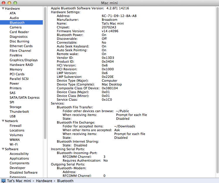

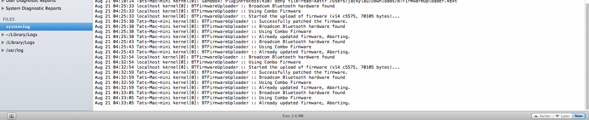

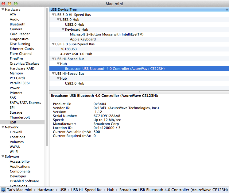

meattattat Posted August 20, 2014 Share Posted August 20, 2014 Hi EMlyDinEsh,I have bought a BCM94352HMB combo Wifi+BT card and I have been reading and searching articles to make it fully work.The Wifi works perfectly with the toleda's BCM4352.kext, however, I am still having troubles with the Bluetooth.I have installed your kext and I know it successfully loaded in the system.log, but in system profiler, "connectable" shows "No" and "discoverable" shows "off". Tried to pair a Magic Mouse but the bluetooth manager just keep searching. I am so frustrated now after hours of try! Attached are the IOReg and the screenshoots of the system profiler, please take a look into it and I hope you could kindly help with this common problem on a combo card. Tat's Mac mini.zip Link to comment Share on other sites More sharing options...
