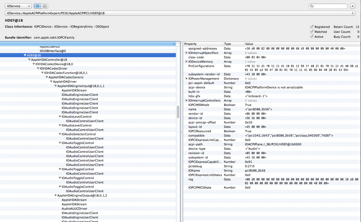

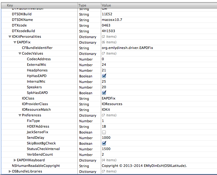

johnny808 Posted October 23, 2014 Share Posted October 23, 2014 *** Edit *** : Issue solved in my next post. All is good now. This is a terrific project, especially for the ALC269 that has an EAPD chip. Thanks for helping so many of us. I'm on Mavericks 10.9.5 with stock patched AppleHDA v2.5.3. Unfortunately, EAPD fix v2 and 1.7.1 are not working for me. I keep getting: EAPDFix: Failed to find Audio device HDEF@1B EAPDFix: Failed to find Audio device HDEF@1B EAPDFix: Failed to find Audio device HDEF@1B I don't know where else to look. That seems correct. Link to comment Share on other sites More sharing options...
