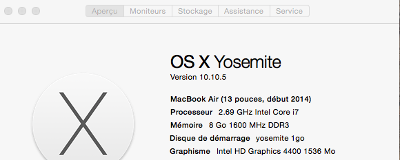

girardpallet Posted September 20, 2015 Share Posted September 20, 2015 Finally i fix it... , just plug the 8Go RAM memory to the other slot. thank anyway @girardpallet which recommendation are you referring to? Refer back to the last few posts. No issue for uranis. His Memory shows correctly as are mine. @uranis, No ,sdcard reader needs to be patch to work, not OOB. Link to comment Share on other sites More sharing options...
