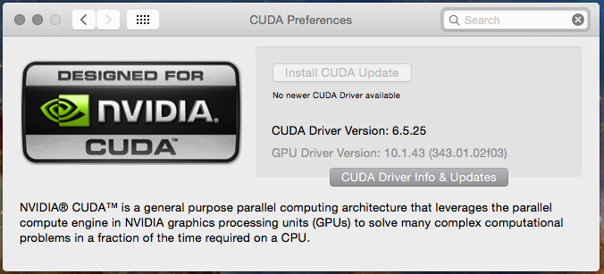

PlutoDelic Posted December 15, 2014 Share Posted December 15, 2014 http://www.notebookcheck.net/NVIDIA-Quadro-NVS-3100M.24738.0.html If by renaming you mean the cosmetic change, it's useless in terms of QE/CI improvement. What matters is that the card details are suitably injected through DSDT if that proves required (for instance if the card is not natively recognized). Once the card details are properly injected, OS X will load the correct nVidia kext and framebuffer; everything should then be Ok. But if the card is natively detected and the OS X-provided nVidia family + framebuffer kexts are loaded, there's nothing else you can do. The only possible "better" kexts could be nVidia's own, if they exist for OS X (for that GPU). Call me stupid for this, but, i went through an experiment as i had nothing to lose. My target was not QE/CI, but i just felt we were using old drivers. I did something, it worked, and probably only you can explain why it works . I downloaded the latest nVidia Web Driver for 10.10.1 in the Quadro section, however from experience i know that it will report incompatible system and wont process further. So i dig a bit more and found a way to extract .pkg files. Copied all the kexts to /S/L/E and pref pane to /S/L/Pref*. Did a kext utility checkup and restarted with the nvda_drv=1 bootflag this time (somewhere i read it doesnt work in Clover??). The Web Drivers seem to have a Web at the end of each file, and it only required one file to be overwritten: NVDAStartup.kext This is the result so far: bash-3.2# kextstat | grep NVD 78 0 0xffffff7f81012000 0x3000 0x3000 com.nvidia.NVDAStartup (10.0.1) <12 4 3> 107 2 0xffffff7f82e7e000 0x275000 0x275000 com.nvidia.web.NVDAResmanTeslaWeb (10.0.1) <88 79 12 5 4 3 1> 109 0 0xffffff7f830f3000 0x2ae000 0x2ae000 com.nvidia.web.NVDANV50HalTeslaWeb (10.0.1) <107 12 4 3> bash-3.2# bash-3.2# kextstat | grep GeF 110 0 0xffffff7f833a1000 0xce000 0xce000 com.nvidia.web.GeForceTeslaWeb (10.0.1) <107 88 79 12 7 5 4 3 1> bash-3.2# Is there any way i can test the difference between the two kext bundles? So far the system feels good, not any major difference but not problems either. I also have my doubts that, even though kextstat displays the kexts with the Web at the end, the version remains 10.0.1, however, Cuda pref pane reports 10.1.43. @, jump in ship please... Link to comment Share on other sites More sharing options...
v3ct0r Posted December 15, 2014 Author Share Posted December 15, 2014 Hey Pluto, Great job! That seems like an awesome breakthrough. What kexts were ADDED to /S/L/E? They may be named something different. I'd try filtering by Date Added/Created Basically, by finding out, you may be able to determine which kext is delivering the version number of 10.1.43. Also, in case you want to try and revert back to your previous state to see the difference, I give you the unmodified NVDAStartup.kext from my system: NVDAStartup.kext.zip Hopefully just a rename of the old NVDAStartup + Other kexts that the install added and a permissions repair after you drop in the attached kext should put you back where you were prior to installing the newer driver. Again, great job and I can't wait to see what this leads to . EDIT: Wanna do us all a favor and try sleep? If I remember correctly, it didn't work previously due to graphics power management! Would the new driver fix that? :0 Link to comment Share on other sites More sharing options...
PlutoDelic Posted December 15, 2014 Share Posted December 15, 2014 No sleep im afraid, but i think i did do something with the Hibernate mode when i initially installed, not sure what though as i cant remember. what about darkwake, could that boot flag help? Also, let me break down what i did. Downloaded latest web drivers from here: http://www.nvidia.co.uk/download/driverResults.aspx/80901/en-ukAs they wont install due to incompatibility, i used unpkg to extract the package. It extracts two folders inside the main directory, one for the /S/L/E and one for /S/L/PreferancePane I cross-compared all files, and they are similar in file naming, though the new ones differ with the *Web.kext at the end, of course as i noted except the aforementioned NVDStartup.kext, which of course, i backed up just in case. it wont activate the drivers unless you boot with the nvda_drv=1 bootflag So to summarise Original Kexts: GeForce.kext GeForceGA.plugin GeForceGLDriver.bundle GeForceTesla.kext GeForceTeslaGLDriver.bundle GeForceTeslaVADriver.bundle GeForceVADriver.bundle NVDAGF100Hal.kext NVDAGK100Hal.kext NVDANV50HalTesla.kext NVDAResman.kext NVDAResmanTesla.kext 10.10.1 Web Drivers GeForceWeb.kext GeForceGLDriverWeb.bundle GeForceTeslaGAWeb.plugin GeForceTeslaGLDriverWeb.bundle GeForceTeslaWeb.kext GeForceTeslaVADriverWeb.bundle GeForceVADriverWeb.bundle NVDAGF100HalWeb.kext NVDAGK100HalWeb.kext NVDAGM100HalWeb.kext NVDANV50HalTeslaWeb.kext NVDAResmanTeslaWeb.kext NVDAResmanWeb.kext Replaced NVDAStartup.kext I personally just dragged and dropped and let Kext Wizard do the usual in /S/L/E Wondering why the Driver Manager preference pange doesnt work... Link to comment Share on other sites More sharing options...

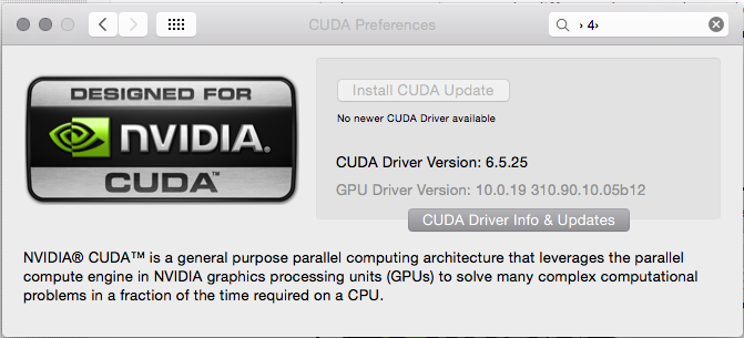

PlutoDelic Posted December 16, 2014 Share Posted December 16, 2014 Just booted without nvda_drv=1, and kextstat shows this: Memlis-MacBook-Pro:~ memlirobaj$ kextstat | grep nvidia 84 0 0xffffff7f81012000 0x3000 0x3000 com.nvidia.NVDAStartup (10.0.1) <12 4 3> 101 2 0xffffff7f8106d000 0x26a000 0x26a000 com.apple.nvidia.classic.NVDAResmanTesla (10.0.0) <85 78 12 5 4 3 1> 102 0 0xffffff7f812e1000 0x2aa000 0x2aa000 com.apple.nvidia.classic.NVDANV50HalTesla (10.0.0) <101 12 4 3> 113 0 0xffffff7f82715000 0x2000 0x2000 com.nvidia.CUDA (1.1.0) <4 1> so version 10.0.0 shows up, at least something has updated for real. Link to comment Share on other sites More sharing options...
