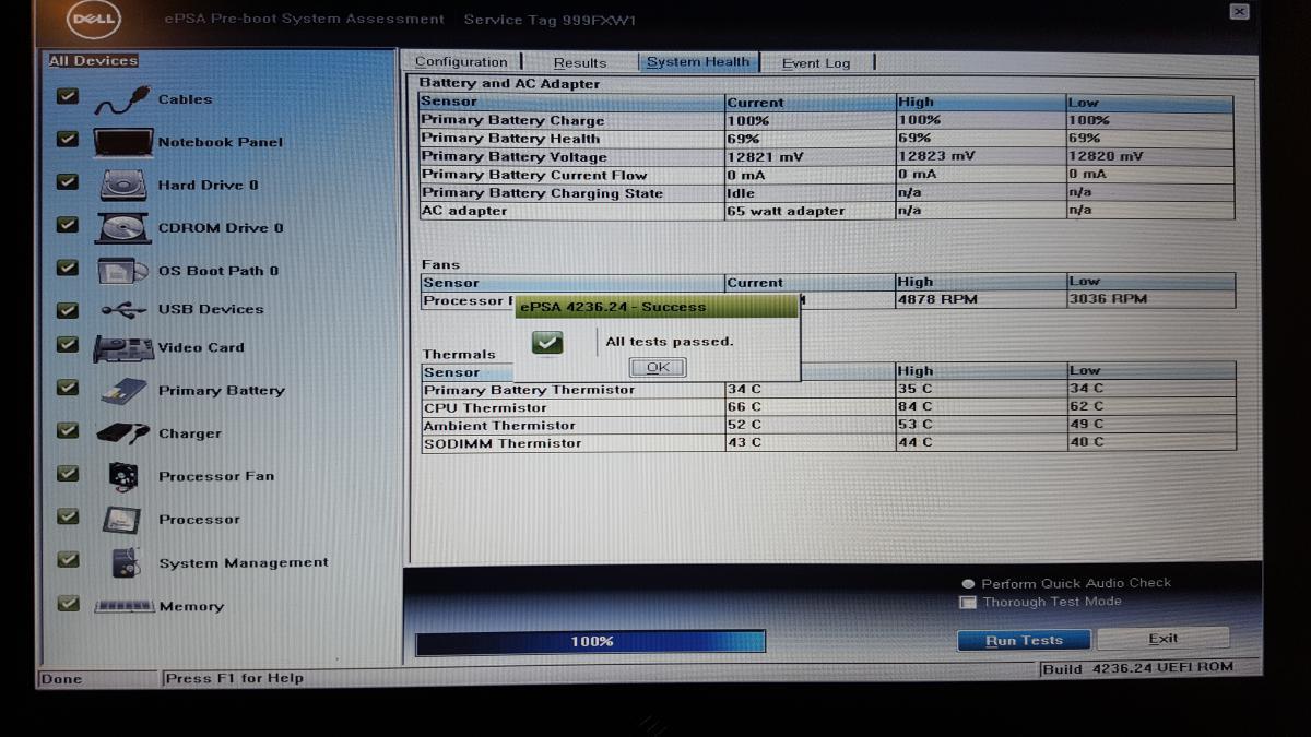

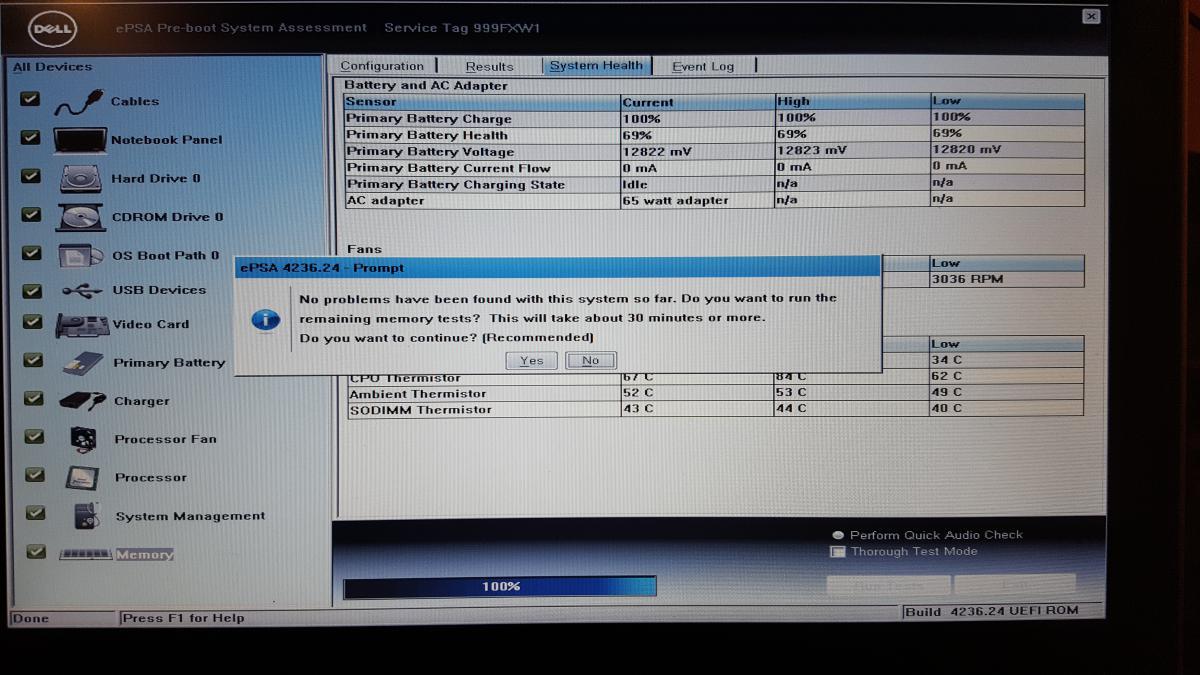

So, I followed your guide to the letter.  Got the same error.  It's as if this device simply won't recognize a bootable usb device.  In the meantime I'm going to try to burn the bootable usb to a dvd and and boot that way, since that's how I installed windows 8.1 on this device.  Attached are some photos for information.  Let me know what you think.
Those screenshots are diagnostics I ran after trying to install 10.11.5 with the clover guide linked above, and for some reason this laptop won't recognize the bootable usb... any ideas why that would be?  I'm fairly certain I have everything configured correctly in the bios. You can see in one of them it says Flash Drive DUO, that is the flash drive the installer is on.
Yes I did, As Far As I'm aware.  This is my first time doing this, so It's possible I missed something.  I followed all the steps in the guide.  Do I need to run something that is located in the drive after I run the clover installer with the flash drive as the target?  If perhaps there was some error with clover is there a way I can put the bootloader on the drive manually.  I burned the contents of the drive to a dvd and attempted booting that, with the same results, so either there is something amiss with this pc, there was some error with clover, or I missed something. Advice? Where would I look on the drive to check and see if the bootloader was installed?

Did you plug your USB drive into the combined eSATA/USB port? It's the only working port for bootable USB devices on my E6330.
