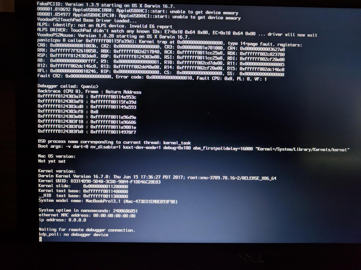

abraxis Posted November 24, 2017 Author Share Posted November 24, 2017 Crash???? Link to comment Share on other sites More sharing options...
Moderators Jake Lo Posted November 24, 2017 Moderators Share Posted November 24, 2017 Your system is booting from different files than what I sent you. I set SMBios to MBP14,1, yours is showing MBP13,1. Are you replacing the files to the correct EFI directory that's booting from? Link to comment Share on other sites More sharing options...

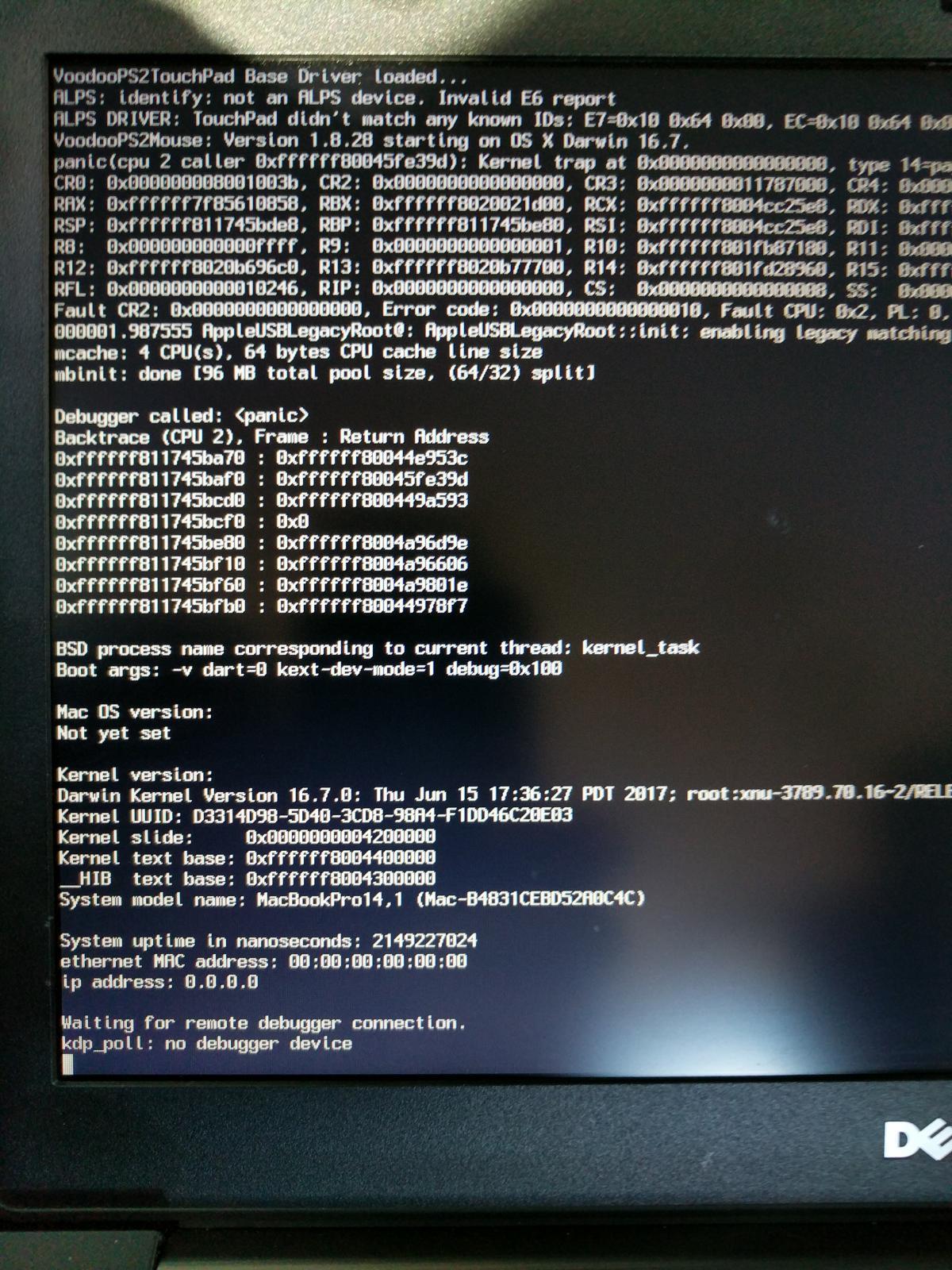

abraxis Posted November 24, 2017 Author Share Posted November 24, 2017 Made sure this time. placed your files in efi. Crash. Cpu is spinning up like crazy also. Never actually reboots after crash. Link to comment Share on other sites More sharing options...
Administrators Bronxteck Posted November 24, 2017 Administrators Share Posted November 24, 2017 looks like it may be the alps trackpad kext causing the issue it seems your trackpad is not alps. 1 Link to comment Share on other sites More sharing options...
Administrators Hervé Posted November 24, 2017 Administrators Share Posted November 24, 2017 According to Dell's support web site, it's an Alps TouchPad alright but I guess too recent of a model to be supported by the installed driver... http://www.dell.com/support/home/us/en/04/drivers/driversdetails?driverId=NVCF6&lwp=rt -> under "Applies to" 1 Link to comment Share on other sites More sharing options...
