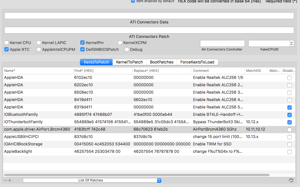

abraxis Posted December 2, 2017 Author Share Posted December 2, 2017 Tried lilu and AirportBrcmFixup in efi/clover/kexts/other . No change Here's my report Jake FYI every other boot my internal display boots to black screen but plugging HDMI shows desktop on monitor...? No idea whats causing this debug_11805.zip Link to comment Share on other sites More sharing options...
Moderators Jake Lo Posted December 2, 2017 Moderators Share Posted December 2, 2017 Were you able to adjust the brightness or the screen just stays black no matter what? Link to comment Share on other sites More sharing options...
abraxis Posted December 2, 2017 Author Share Posted December 2, 2017 screen stays black. Hard reboot and usually laptop display is back on next restart. I also tried setting GUI to 1366x768. which is the laptops native resolution Link to comment Share on other sites More sharing options...
abraxis Posted December 2, 2017 Author Share Posted December 2, 2017 However backlight becomes way more erratic. It boots with the screen at the lowest brightnes, almost pitch black. I had to do a hard reset to get the backlight at a normal level. Still can't control it if not waking from sleep. That was for both the DSDTs. It has also happened with the original DSDT. The backlight issue (power management in general?) is actually the most troublesome. this actually sounds like my issue. My screen is booting to black screen every other boot up Link to comment Share on other sites More sharing options...
black.dragon74 Posted December 2, 2017 Share Posted December 2, 2017 this actually sounds like my issue. My screen is booting to black screen every other boot upAre you using AppleBacklightInjector? This generally happens due to missing PNLF device. Regards 1 Link to comment Share on other sites More sharing options...
