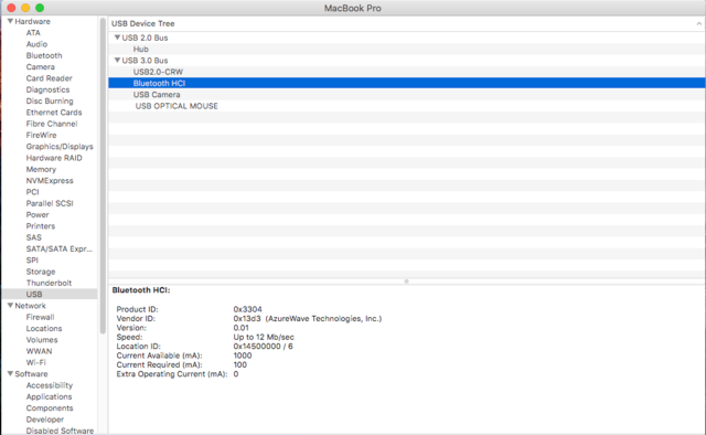

Rjoe Posted December 29, 2015 Share Posted December 29, 2015 At my Asus x450jf (El Cap 10.11.2), shif+caps+f2 (fn+f2) does not work to switch off bluetooth ar3011 (VID: 13d3 PID: 3304) Any suggestion...? Link to comment Share on other sites More sharing options...
