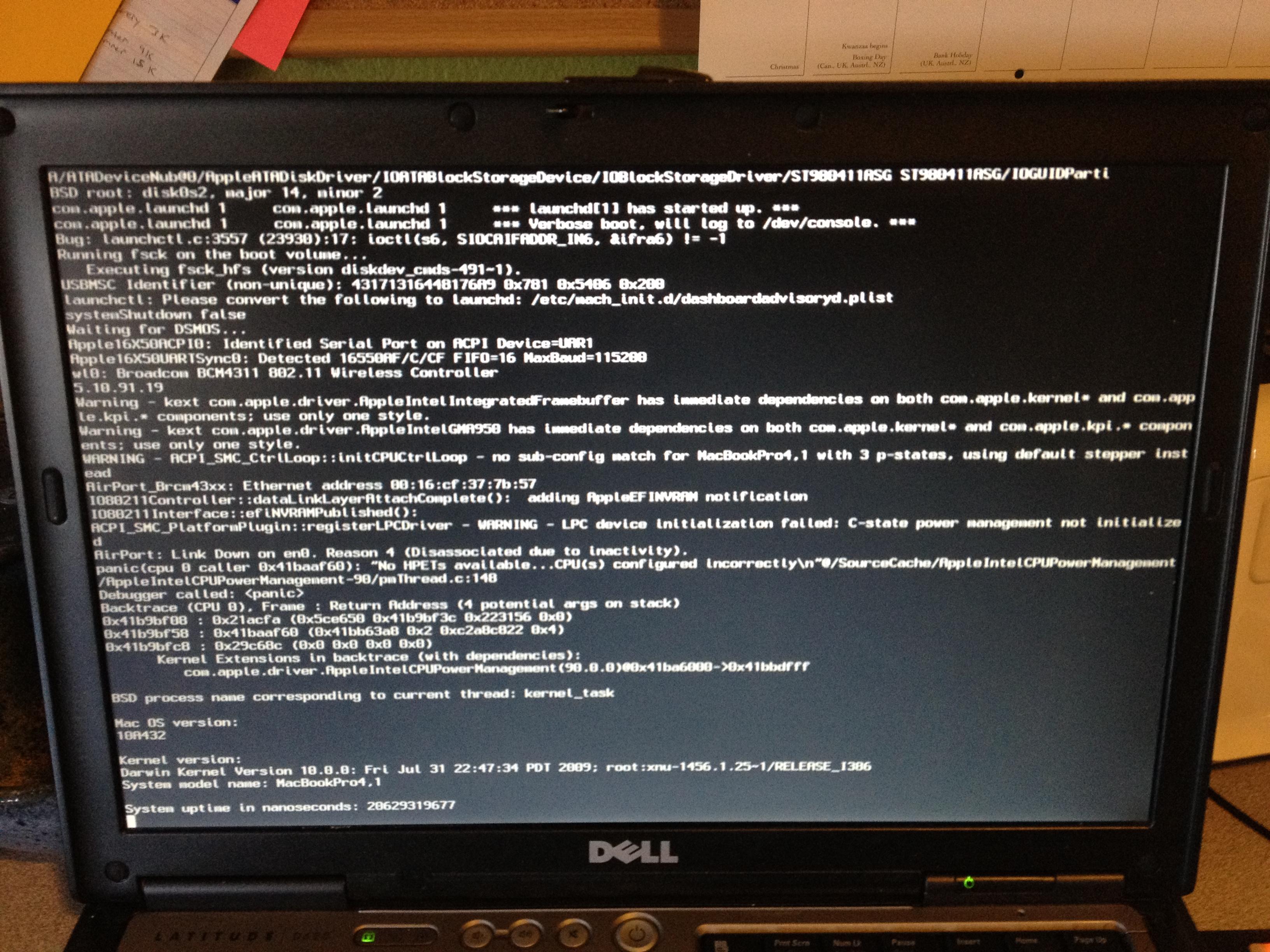

Uloga Posted June 10, 2012 Share Posted June 10, 2012 Hello, I've created my USB boot as described in the main guide on this website. But when I try to boot with -v I'm not getting past "System uptime in nanoseconds" I did turn off the WiFi And I also tried -v -x which gives me rooting via boot-uuid from /chosen :xxxxxx and just hangs there... Am I doing something wrong?? I have the GMA Edition Link to comment Share on other sites More sharing options...
Administrators Syonagar Posted June 10, 2012 Administrators Share Posted June 10, 2012 Dear uloga, Have you tried to set you hard disk setting in bios to AHCI? Cheers! Link to comment Share on other sites More sharing options...
Uloga Posted June 10, 2012 Share Posted June 10, 2012 I cannot find it in the bios settings EDIT: The problem lies with the Extra folder! If I use the standard extra folder from myHack it works! Link to comment Share on other sites More sharing options...
Administrators Bronxteck Posted June 10, 2012 Administrators Share Posted June 10, 2012 d620 does not have AHCI option for sata in bios.... it sounds like you have a build issue with the kernelcatch build run edp 3 Link to comment Share on other sites More sharing options...
