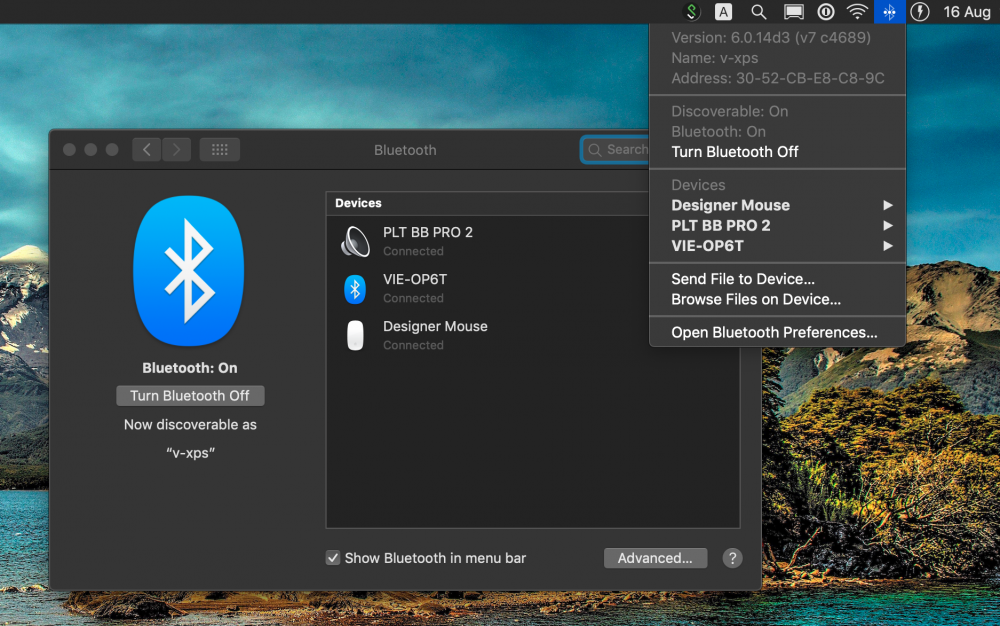

vichaos Posted August 16, 2019 Share Posted August 16, 2019 After struggling with bluetooth range and bandwidth i think this bluetooth version work best on my XPS9360. I put attached kexts in /L/E, AirportBrcmFixup.kext in clover and added brcmfx-driver=1 brcmfx-country=TH in clover boot arguments. BrcmBluetoothInjector.kext.zip BrcmFirmwareData.kext.zip BrcmPatchRAM2.kext.zip Link to comment Share on other sites More sharing options...
Administrators Hervé Posted August 16, 2019 Administrators Share Posted August 16, 2019 Firmware v4689, right? How does Bluetooth work after Sleep & Wake? Link to comment Share on other sites More sharing options...
