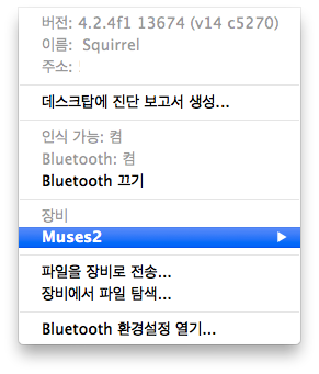

Squirrel Posted June 10, 2014 Share Posted June 10, 2014 Broadcom BCM94352HMB / AzureWave AW-CE123H 10.9.3 Sleep Before and after v14 c5270 http://cfile30.uf.tistory.com/image/271CF73953973111088CCE v14 c4096 http://cfile10.uf.tistory.com/image/2545CB395397311102BB69 Bug fixed? Sorry I do not know English. Google translate Link to comment Share on other sites More sharing options...

EMlyDinEsH Posted June 18, 2014 Author Share Posted June 18, 2014 Broadcom BCM94352HMB / AzureWave AW-CE123H 10.9.3 Sleep Before and after v14 c5270 http://cfile30.uf.tistory.com/image/271CF73953973111088CCE v14 c4096 http://cfile10.uf.tistory.com/image/2545CB395397311102BB69 Bug fixed? Sorry I do not know English. Google translate What are your Broadcom ids? Can you send me an ioreg file(use IORegistrExplorer v2.1 or lower) and your system log before and after sleep with my kext? EDIT: Did you use my kext? which version of my kext installed? Send me your systems logs and ioreg i've asked before with my kext. Link to comment Share on other sites More sharing options...
