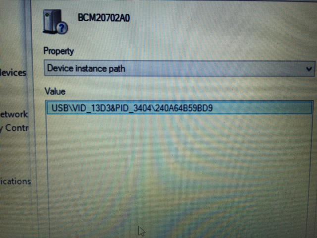

mine2hit Posted June 30, 2015 Share Posted June 30, 2015 Sorry for late reply, i dont see your BT device in ioreg. can you do rest BIOS and remove battery then do a clean boot and get me your system log/ioreg? Hi.. Thanks Bro... i tried your new version and its not working.. i managed to get my bluetooth device details from windows.. Vendor ID 13D3 Product ID 3404 and i've extracted the firmware and enclosed. Please help me fix this..! BCM20702A1_001.002.014.1443.1479.hex.zip Link to comment Share on other sites More sharing options...
