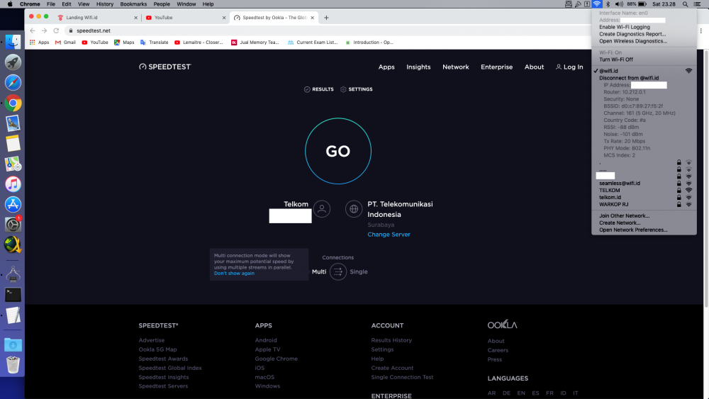

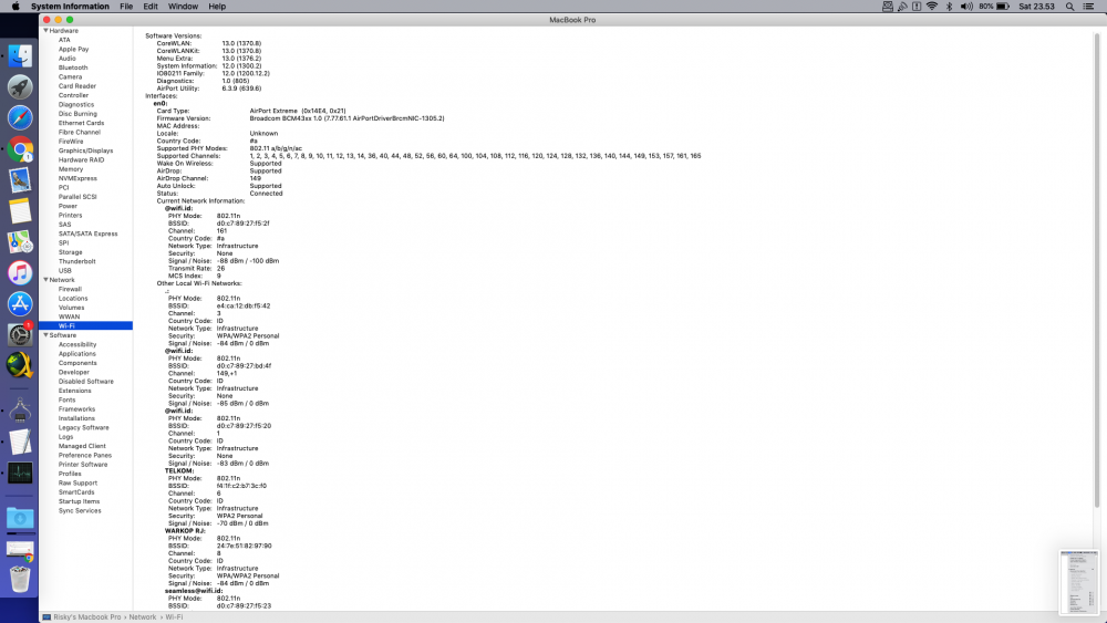

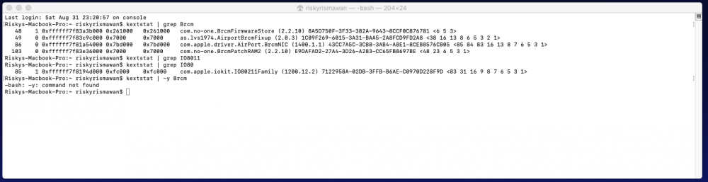

StuART357 Posted August 31, 2019 Share Posted August 31, 2019 Hi everyone, just re-purchased the correct 0VW3T model and everything works now, even until now i'm using AirPortBrcmNIC driver, but the wifi sometimes disconnect from 5Ghz to 2.4 Ghz, because i broke the NGFF antenna connector, but it's ok though, shutdown, sleep, wake restart OK, wifi still works, Airdrop, handoff, but sometimes DW1820A wont connect to Instant Hotspot, cheers. also yesterday i watched movie for 4 Hours and no sudden freeze, kernel panic, or cpu usage increase. P.S : i used the pin mask fix from @DalianSky WORKS Great for me, using Acer swift 3 notebook Link to comment Share on other sites More sharing options...
Administrators Hervé Posted August 31, 2019 Administrators Share Posted August 31, 2019 @riskyrismawan, you forgot to specify the boot parameter you're using with AirPrtBrcmFixup, if any at all. If you're not using any, what's the purpose of AirportBrcmFixup since BCM4350 14e4:43a3 is natively controlled through AirPortBrcmNIC kext? Link to comment Share on other sites More sharing options...
