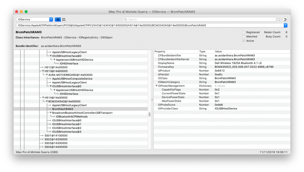

Hi, I installed a DW1820A (model 0VW3T3) on Asus ROG Strix Z390-I.
Wi-Fi was working OOB, BT didn't.
I managed to configure it by using BrcmPatchRAM but only Handoff/Continuity work. It detects AirPods, Trackpad etc. but it fails to connect.
I'm currently on macOS Catalina 10.15.1 and I'm using BrcmBluetoothInjector+BrcmFirmwareData+BrcmPatchRAM3 kexts injected via Clover.
2107684117_Schermata2019-11-11alle19_08_14.thumb.png.c4b47bfd85ac879191750e3e992c434a.png
This is what happens during boot:
If I boot Windows and then reboot in macOS, firmware became 5799 and BT works.
Can someone give me a hint? Thank you!
