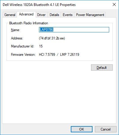

punjabigator Posted October 5, 2019 Share Posted October 5, 2019 Update: I was able to extract the files in Windows and able to copy the most recent firmware. So far I have three firmwares: 5974 (most recent, attached below), 5803, and 4689. Every time I tried new firmware, I was able to connect Majic Mouse, however, after a successful connection, it never worked again. any suggestion? wifi works great! There is new Dell 1820A (Wifi: 14e4:43a3; BT: 0x0A5C:0x6412) Firmware at this Dell 1820A link . Herve can please illustrate how to extract the firmware? BCM4350C5_003.006.007.0095.1878.hex.zip Link to comment Share on other sites More sharing options...
Administrators Hervé Posted October 5, 2019 Administrators Share Posted October 5, 2019 You extract the firmware from Windows: simply run the .exe and opt to extract the files or, if you like like more complicated, open the .exe file with, say, Winzip and extract the files. The .hex firmware files are located in the BT subfolders... I'm currently running with firmware v5799 and will try this v5974 that you've posted. Link to comment Share on other sites More sharing options...
