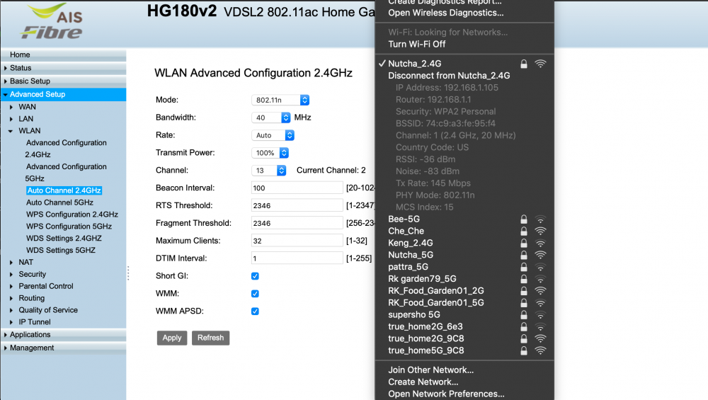

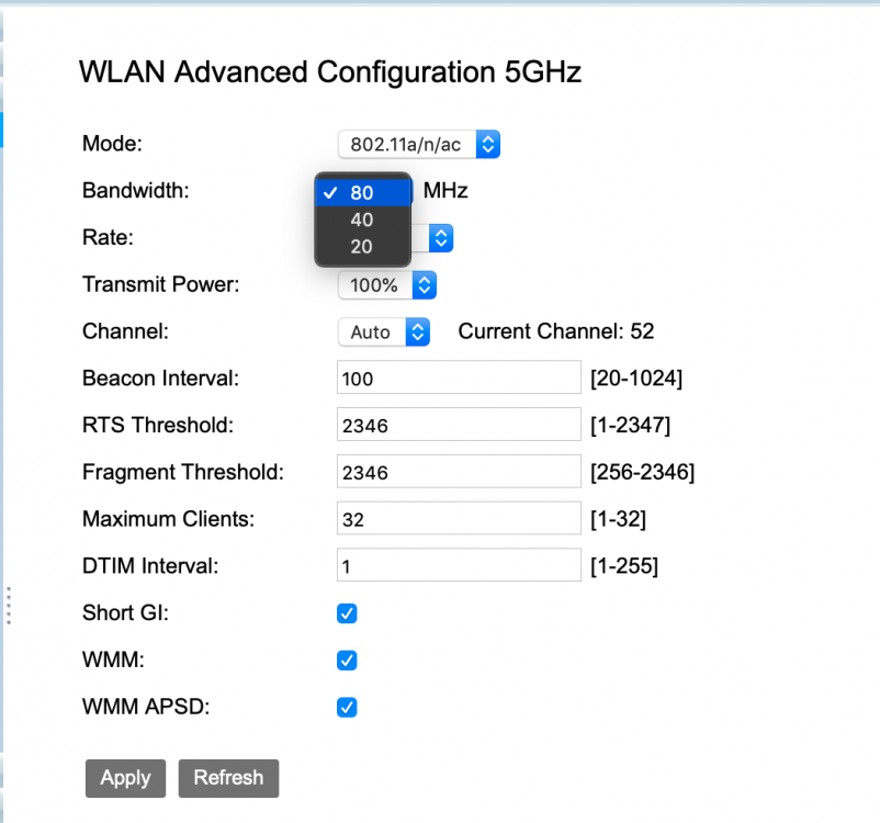

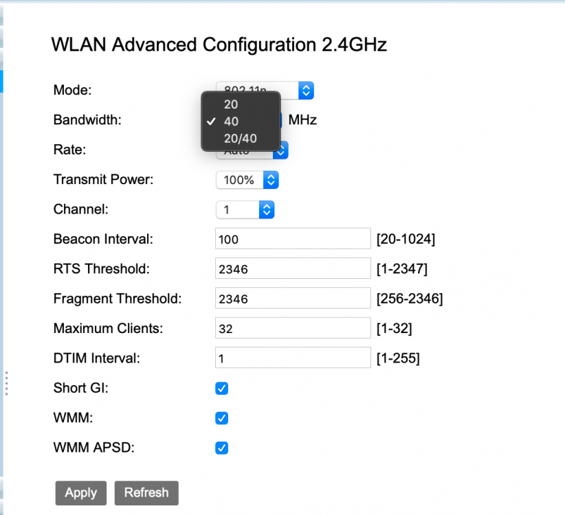

vichaos Posted August 21, 2019 Share Posted August 21, 2019 46 minutes ago, Hervé said: I believe I had explained in may guide that combining compatibility with 14e4:4353 injection + boot parameter brcmfx-driver=1 caused issues to me. Try without the boot parameter. What's interesting though -and that's probably key- is that your system runs Ok if you restrict the card to 40MHz. But is that on the 5GHz or, presumably, the 2.4GHz network band? For 2.4Ghz the bandwidth is locked to 20MHz only adjusting the wireless router doesn't effect anything at all the bandwidth is always 145Mbps. For 5.0GHz I'm able to connect to all the bandwidth 20/40/80MHz only 80MHz is seem to cause many issues such as kernel panic at boot/restart and system sometime freeze. But I just try limiting the throughput(from 867Mbps to 780Mbps) while staying at Bandwidth 80MHz seem to work flawlessly. But I think I prefer to stay with 5GHz 40MHz to avoid random kernel panic on start/reboot/shutdown. Without brcmfx-driver=1 I always get kernel panic one time before booted up and the machine, sometime turn on itself after shutdown. Link to comment Share on other sites More sharing options...
